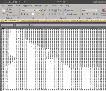

In order for the image to fit the dimensions of your design board, you will need to resize the image to the number of BBs wide and the number of BBs long. After resizing the image you will need to transfer the image into a CSV file. To do this there is a program called A-vekt that allows you to convert an image to a CVS file. When you open the CVS file it will bring you to the Microsoft program Excel where you will find the rows and columns showing you how to lay down the BBs.

Using the excel map place your BBs into the design board. After this process is done take the 4th spacer and glue it to the end of the design board to prevent the BBs from falling out. Numbering the grooves is a good way to keep track of what row you are placing the BBs into. This will prevent you from having small errors like the few in mine.
