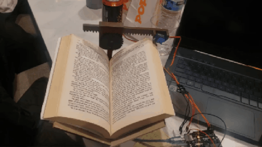

This is an attempt at an Automatic Page turner for a book using 2 servos, an arduino uno, and a button. This was completed for a final project for a class.
My intention for the project is for it to be a portable, and simple mechanism that can be easily carried around and installed at a moments notice.
The book stand is an easy slot mechanism with holes at the top to hold the page turning mechanism.

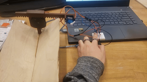

When I first iterated on this design, I had been trying to figure out the best combinations of motors to get the motion for turning the page.
I did not realize how much motion goes into turning the page of the book so I believe I got overconfident and the design is too simple to handle turning a page. With this in mind, I am still proud of the work I was able to do.
As you can see in the gif, it does not turn the page all the way, but slightly picks it up. When I iterate on this again, I will be using a continuous servo instead of a 180 to make sure the actuator (lienear motion at the top) can travel farther across the book. I could also implement anouther servo at the bottom of the stand to grab the picked up page and drag it across.

Here is the first iteration of the rack and pinion linear actuator I did using a DC motor: Linear Actuator
In order to accomodate for the height the linear actuator needs to sit on the bookstand, I added to the top a length in order to slide through a hole in the bookstand. I can use small clamps to adjust the height in case it is a thick book.
I also re-included the servo holders from the initial design in order for me to add a servo unit instead of using the DC motor which moved the mechanism too fast. I removed the space at the bottom for screws to save plastic and make it look less bulky. This will be sitting upside down on the book stand. I used super glue to join these pieces together.

In order to have the book be held at a good angle, I created this stand in Adobe Illustrator and used a laser cutter to cut it out.
This first iteration(BookStandAttempt2.pdf) is very shakey because I did not give it enough length on the legs to keep it stable when setting it down.
For the next iteration I will be including a gap where I can slide the linear actuator to position the motors properly in comparison to the book. (BookStandAttempt3-SlotsAndLonger.pdf)

I had to sand the slots down a bit to fit the arm of the linear actuator. As well. I realized it is hard to fit a clamp in the space I left for the book stand. I will have to iterate on this for later.
