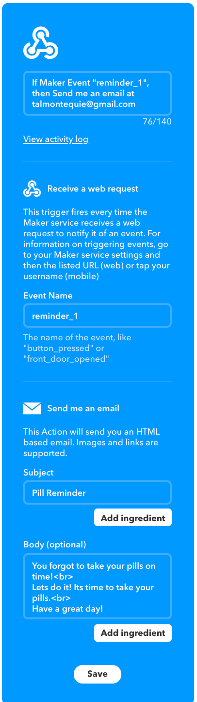

Step 5: IFTTT Configuration
We made 3 IFTTT events:
  1. reminder_1 - in case the daily pills have not been taken within the time-frame required, an email reminder will be sent to the user, to remind him to take his pills
  2. reminder_2 - in case the user has yet to take his pills, after the given time frame and after the first reminder, an email will be sent to a family member or medical assistant – informing them that the daily pills have not been taken
  3. fill_pill - at the end of the week, a reminder to fill up the pills for the next week will be sent to the user, including instructions of the dosages and types of pills for each day – via email
