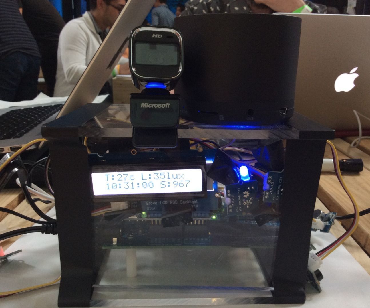

Through our own hardware, a multi-wireless IoT Gateway, we use advanced big data analytics and machine learning to create situation and context aware real time voice prompt or mobile notifications at the right time with the right content, based on private and public datasets.
Ultimately it's an smart, easy to use IFTTT engine for IoT!
HOW IT WORKS?
- IoT Gateway Sensor Ingestion + API Mesh-up
- Our IoT Gateway communicate to various connected devices (IoT), securely uploads data to our AI IoT Cloud for advanced analytics.

- Drag-and-drop Flow Editor for sensors, actuators, and API meshing
- designed by IBM IoT Team for non-programmers to define rules, recipes
- meshing up sensors, actuators, APIs, products / services - a truly modular / component based design

Step 3: Demo #1: OEM Trackimo for Elderly People
Grandpa develops early dementia symptoms. We are worried about him getting lost more often.
Thanks for Trackimo device + GEO fencing AP, we designed two 3D-printed prototypes:
- Smart Stick
- Connected Umbrella
Step 4: Demo #2: Stress-Free Holidays
Water leaked!!
Our Moisture Sensor detects straightway
Thanks for the “Holiday Home Monitor Recipe” downloaded into Life++ AI Box, home owner + neighbour + Allianz Assisted Service will be notified - so u don’t have to worry about it…
