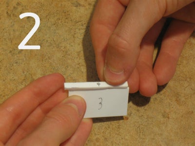

2: Find both 3s and 4s. Glue each 3 to a corresponding 4. These are the middle clips of the GoPro mount. The corresponding photo shows which way to offset both top pieces.

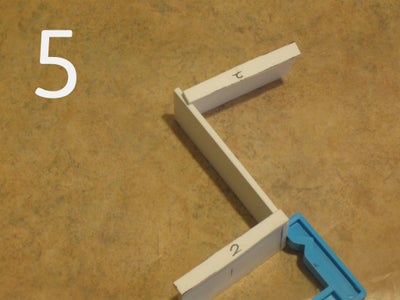

3: Find both 5s and 6s. Glue each 5 to a corresponding 6. This clips onto the sides of the iPhone.

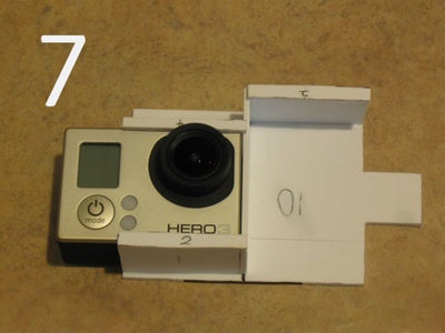

7: Grab one of your GoPros, and put it where it will go when the mount is done. Mark a line along the edge of the GoPro where a 3 & 4 combination will go. Do this for both positions. Remove your GoPro once you are done marking.

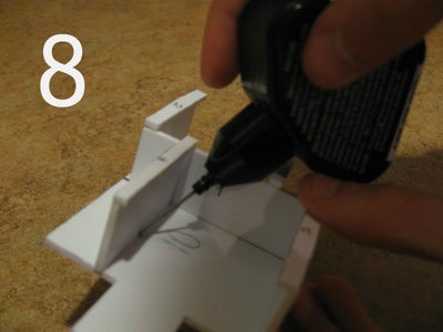

8: Glue down both 3 & 4 parts, where you just marked, put glue wherever it touches another piece.
9: Flip over the main part of the mount. Glue 5 & 6 end-on to piece 10, so that it sits next to the mark.
