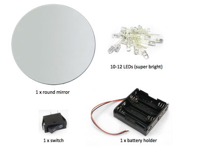

Next you will need materials for the lighting.
This includes:
- A food container (JÄMKA) (around $2)
- LEDs (around $2)
- Something round (like a Nutella lid or old roll of tape)
- A switch ($0.50)
- A battery pack ($1)
- Some batteries ($1)
- Some wire, solder and double-sided tape or glue (next to nothing)
- A round mirror (can get these for $2)
- Some adhesive copper tape (not necessary but what I used here)

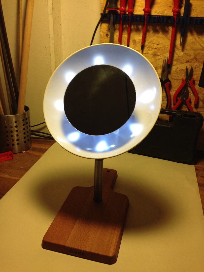

Step 2: Hack the Food Container
- Stick the mirror onto the lid (for example using double sided tape)
- Drill a hole for the switch

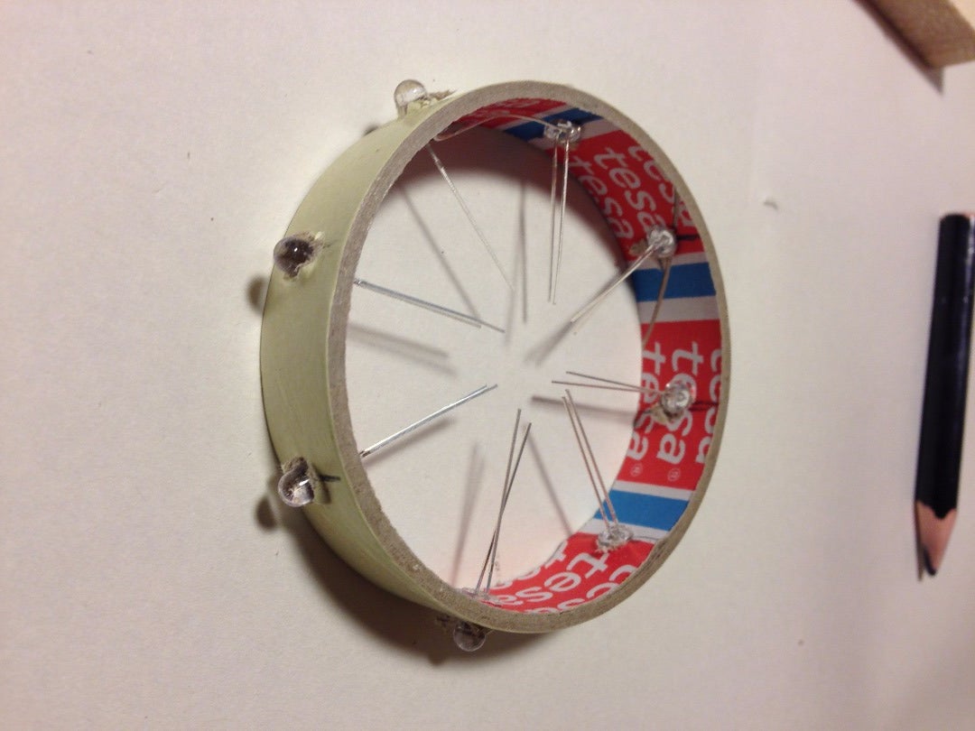

- Drill holes for the LEDs and connect them to the tape roll (or Nutella lid or similar)
- Connect them in parallel using the adhesive copper tape, or directly from one LED to the next (ensure to keep the short and long legs respectively on the same copper path)
- Put the role of tape with LEDs into the container and secure using glue (e.g. a glue gun) or tape
- Connect the switch and LEDs to a battery pack (I used 3 batteries here in a 4 battery pack and soldered the 4th using wire)
- Put the lid on
- Switch it on

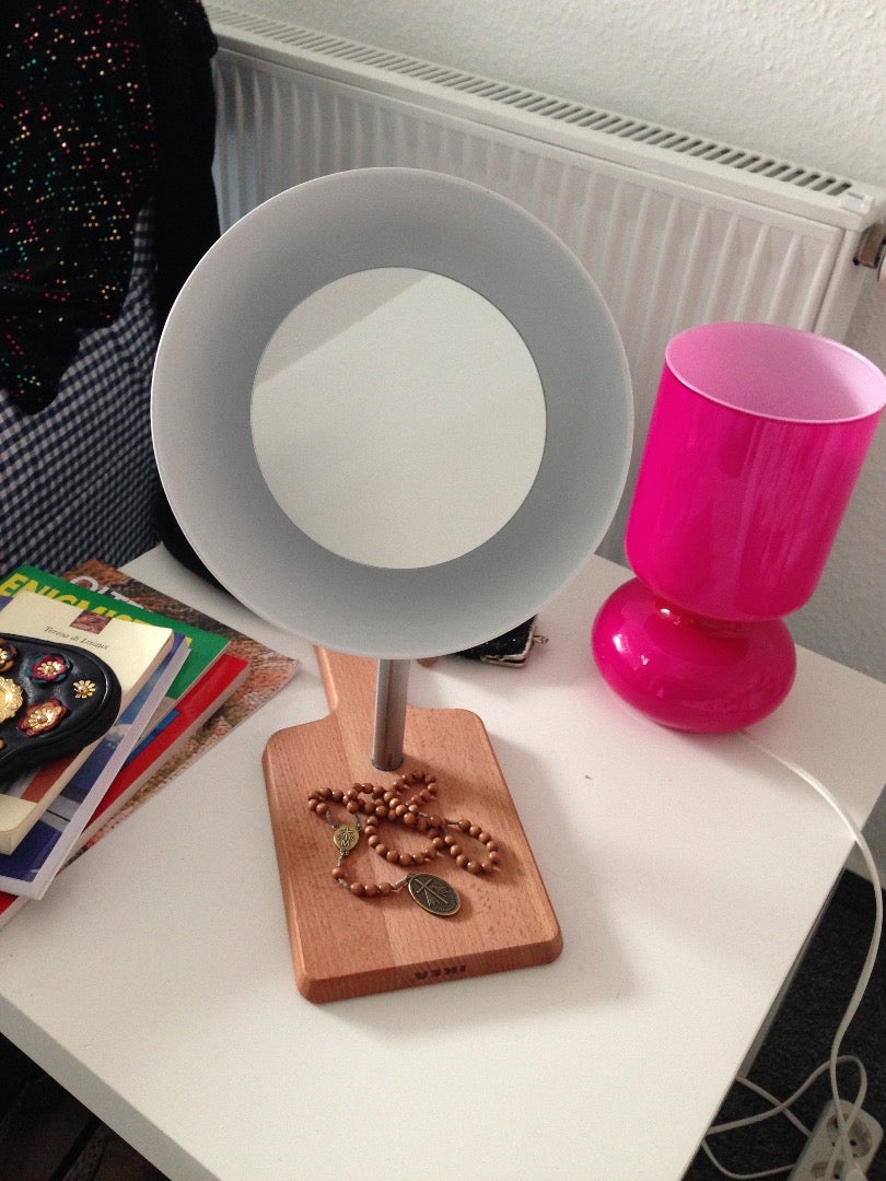

Step 3: Add the Illuminated Container to the Bowl
Stick the container onto the bowl, ensuring that it is evenly spaced

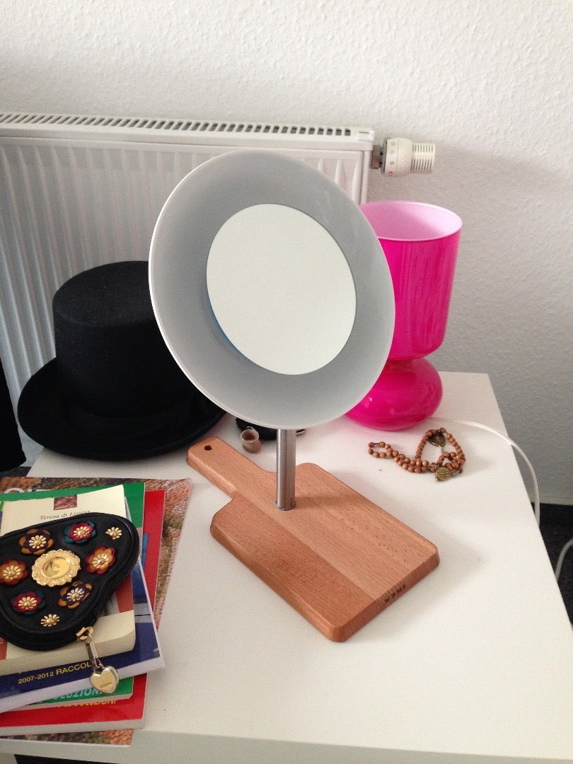

Step 4: Build the Stand, Add the Illuminated Food Container and Complete the Cosmetic Mirror

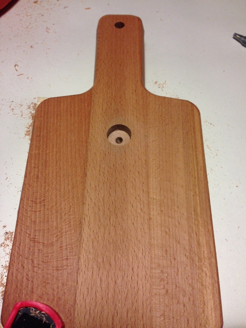

- Drill a hole in the cutting board for the spatula
- Glue the spatula to the bowl (a glue gun works well here)
- Add the bowl/spatula to the cutting board and glue
- Add the illuminated food container/mirror from the previous step to the bowl
- And switch it on!

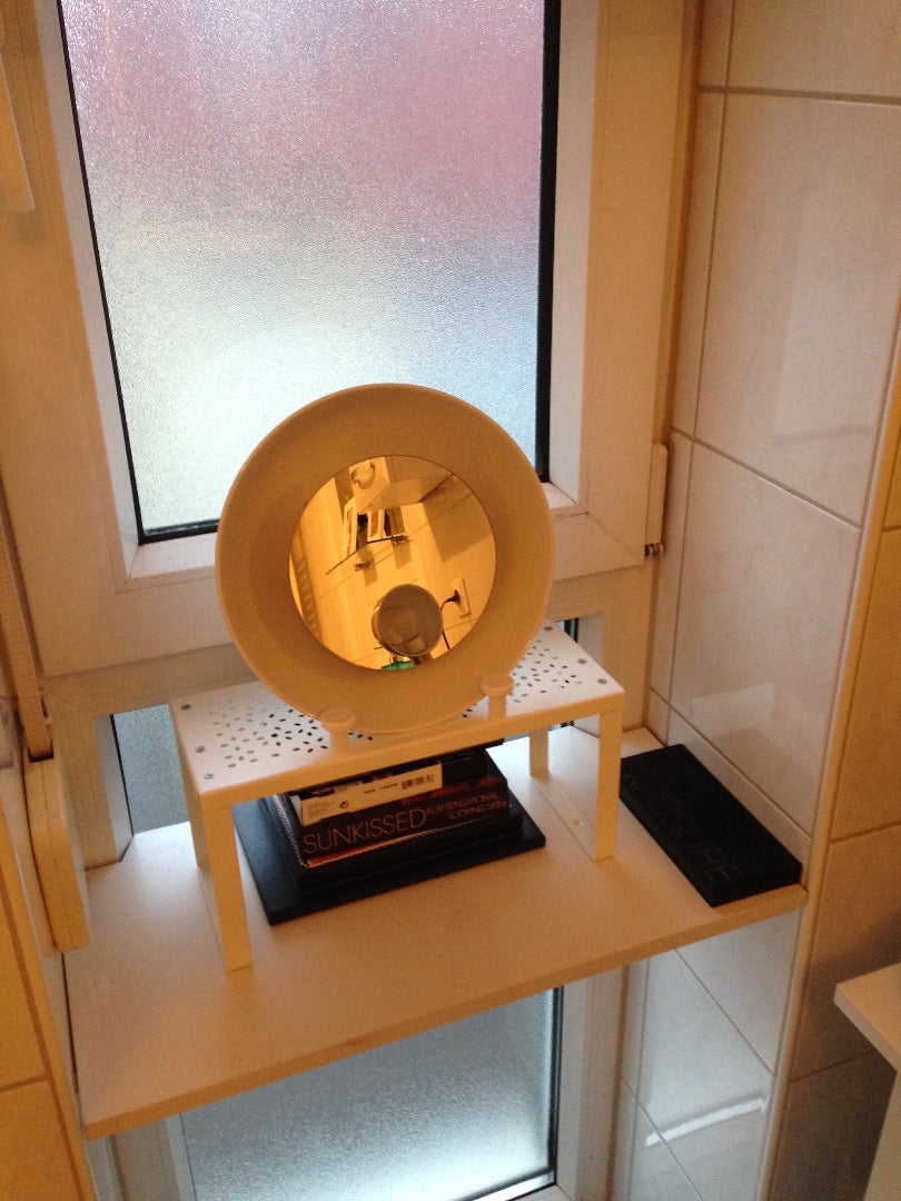

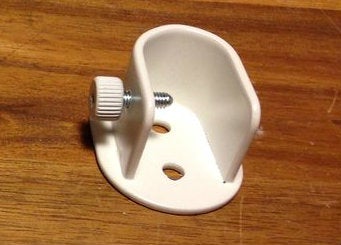

Step 5: Alternative: Variera Stand
- Build the Variera stand as per the instructions
- Drill holes for the fittings and connect
- Fasten the dowling to the holder
- The stand is complete!
- Add the illuminated ceramic cosmetic bowl
- And switch it on!

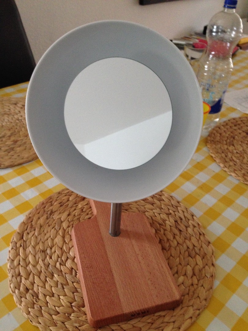

Step 6: More Photos
Some more photos of the two versions
