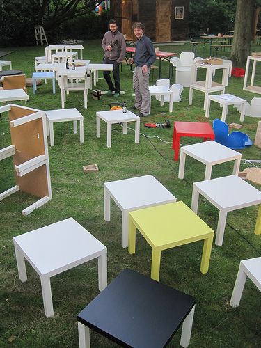

The IKEA Hack-a-Lack is a screwing-device for those who need to assemble a large number of IKEA Lack coffeetables. It saves time, energy and painful wrists. It's very easy to make and the best part is that it is actually made from a Lack table itself. It works like a very big screwdriver but instead of screws it fits tablelegs. For the exhibition Platform21=Hacking IKEA we had to assemble some 1000 LACK's so you may imagine we needed all the help we can invent. The principle of the whole thing is best explained through the instruction of IKEA itself.
