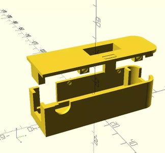

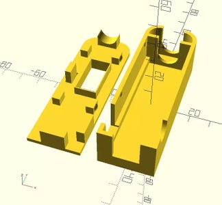

  4. Plastic 3d printed case

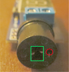

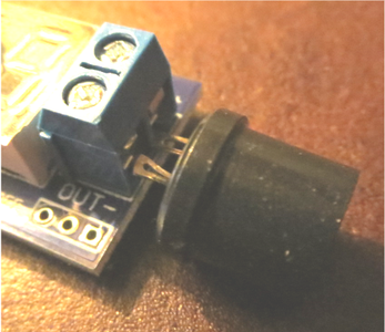

Step 1: Attach Dual Inline (DIN) Connector
If the metal pins are loose, super-glue them to the plastic. Bend the pins of the DIN connector so they are horizontal and fit into the screw terminals of the DC variable transformer. The rectangle goes on the negative-ground side. Tighten screw terminals.

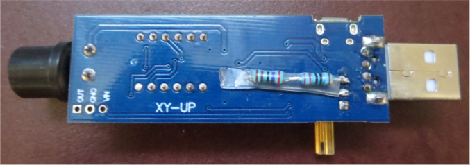

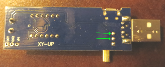

Step 3: Attach Voltage Limiter
Position the DC power supply so the back is faces upward. Solder resistors to two pins nearest to the center.
  1. 4v: 2920 Ohm (2700 + 220: in series)
  2. 7v: 6280 Ohm (5600 + 680: in series)
  3. 21v: 76,600 Ohm (100,000 || 330,000: in parallel)
Put heat shrink or tape over of the resistors.
You can use different resistors as long as they add up to the same resistance.
Resistor calculator: https://jansson.us/resistors.html
You can skip the resistors, if you remember to never exceed the lamp voltage
(Caution: exceeding the lamp voltage will destroy the LED).
Step 4: Put Board Into Case
Put the circuit board into the 3d printed case. It's should fit tightly and doesn't require screws.
