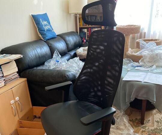

Step 8: Enjoy!
It is easier to show with the diagram than to explain. The left lever locks and unlocks the backrest, which is sprung forward. For me, it is comfortable to leave the chair unlocked so I can lean back. The right lever adjusts the height like normal.
I recommend ripping off the tag on the bottom of the chair, as it covers one of the levers. To clean up, it is easiest to use one of the larger bags to store the smaller bags.
I hope this article helped you assemble your IKEA Markus chair! The provided instructions are helpful, but this article is to provide some actual pictures and to hopefully clarify some steps.
