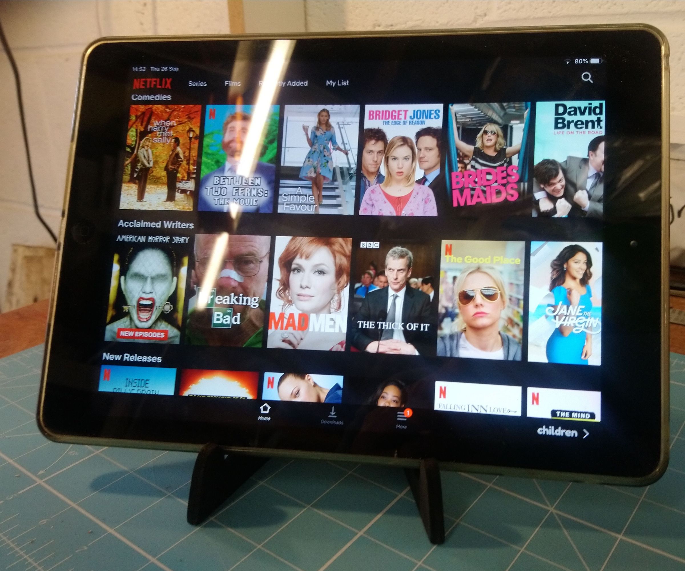

Oh, and as a last minute brainwave, I added a piece of 1/4" ply as an under shelf, complete with half moon cutout, so my IPad can live there.
