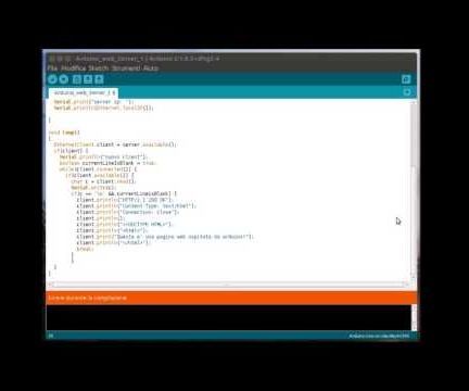

#define trigger_pin 7#define echo_pin 6#define buzzer_pin 13#define porta_rele1 10#define led_verde 8#define led_rosso 9#include LiquidCrystal lcd(12, 11, 5, 4, 3, 2); void setup() { // Setto i pin digitali pinMode( trigger_pin, OUTPUT );pinMode( echo_pin, INPUT );pinMode( led_rosso, OUTPUT );pinMode( led_verde, OUTPUT );pinMode( porta_rele1, OUTPUT);pinMode( buzzer_pin,OUTPUT);digitalWrite(porta_rele1, HIGH); lcd.begin(16,2);} void loop() { if( getDistance() < 9){ digitalWrite(led_rosso, HIGH); digitalWrite(led_verde, LOW); digitalWrite(buzzer_pin,HIGH); tone(buzzer_pin,1000,2000); svuota(); } else { digitalWrite(led_rosso, LOW); digitalWrite(led_verde, HIGH); } // Stampo sul display LCD la distanza rilevata printLCD(getDistance()); } void printLCD(float distance) { lcd.clear(); lcd.setCursor(0, 0); lcd.print("Liv.Sentina: "); lcd.print(14-distance); lcd.setCursor(0,1); if(distance > 13) {lcd.print(“Liv.Normale “);} else if(distance > 9) { //distanza compresa tra 5 e 11lcd.print(“Liv.In Aumento “);} else if(distance < 9) { //distanza minore di 5 lcd.print("Liv.Critico"); } delay(100); } //questa funzione attiva la pompa attraverso il releé e la ferma solamente quando la distanza diventa maggiore di 11 void svuota() { while(getDistance() < 11) { digitalWrite(porta_rele1, LOW); printLCD(getDistance()); delay(500); } digitalWrite(porta_rele1, HIGH); } float getDistance() { float soundSpeed = 334; float microSecondsPerCm = 10000 / soundSpeed; digitalWrite(trigger_pin, LOW); delayMicroseconds(2); digitalWrite(trigger_pin, HIGH); delayMicroseconds(10); digitalWrite(trigger_pin, LOW); long duration = pulseIn(echo_pin, HIGH); float distance = duration / microSecondsPerCm /2; delay(100); return distance; }
