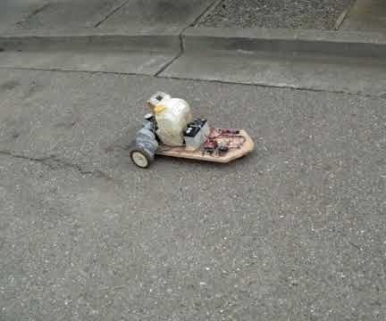

OK, I can't enter StreetWriter into the contest, but I can use it as a platform or, if you prefer, as a printer.
StreetWriter's normal mode is to fetch text from a file on an SDCard, and print out the chracters one at a time in water on the pavement. The Pi day video above used a text file containing Pi to 300 places.
It takes about 100 linear feet to print it all.
This year's idea is to see if it is possible to use the Arduino Uno that controls StreetWriter to compute the digits of Pi on the fly and print them one at a time as they are computed, rather than just reading them from a file.
This approach might allow StreetWriter to produce INFINITE Pi.

Step 4: IT WORKS
So, the task is to take StreetWriter code, and merge in Jurs' code so that instead of fetching digits from a file, StreetWriter computes a digit of Pi then prints it on the pavement, then computes the next digit of Pi and prints that.
It continues to do this until it runs out of water or space to write, or until I get bored.
And as it writes digits of Pi in hexadecimal. and as the time required to compute each digit increases, the spacing between digits on the pavement increases.
In the attached video, I have skipped ahead somewhat to show that effect without you having to get bored too.
I have also included stills at the start, 100th, 500th and 1000th digits for anyone with a really short attention span.
