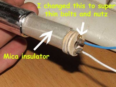

Step 7: Ultimate Insulator...
This mica roll I removed from the inside barrel of the hot air gun...just perfect, to roll up into a smaller size and insert into my scooter handle...be careful in rolling it as this stuff is brittle. This would help shield the main metal barrel from the radiating heat emitted from ceramic tube shown later.

Step 15: How to Connect Element to Power Supply.
I recycled some connections from the heat gun and used those to create the essential connection between the element and power wires. I later discarded this rivet idea, as I wanted something later that would allow easy removal and replacement of a stuffed element. I opted to use super thin bolts and nuts and small spring washers to join the two ends together. There is nothing preventing this idea of the rivets holding the wires together if you can not find nuts and bolts small enough to do the job. Remember that they must be small enough to clear the outer metal casing...you don't want an electrical contact here...lol
Step 16: Close Up of the Rivet Joining
This is a close up of the rivet idea...As i said, i ended up using thin bolts and nuts attchacing the wires here.

Step 20: Fitting the Power Connection
This is the rivet idea still and how it all fits into place...the idea I used was much cleaner than this, where I discarded the rivet method and used nuts and bolts instead.
