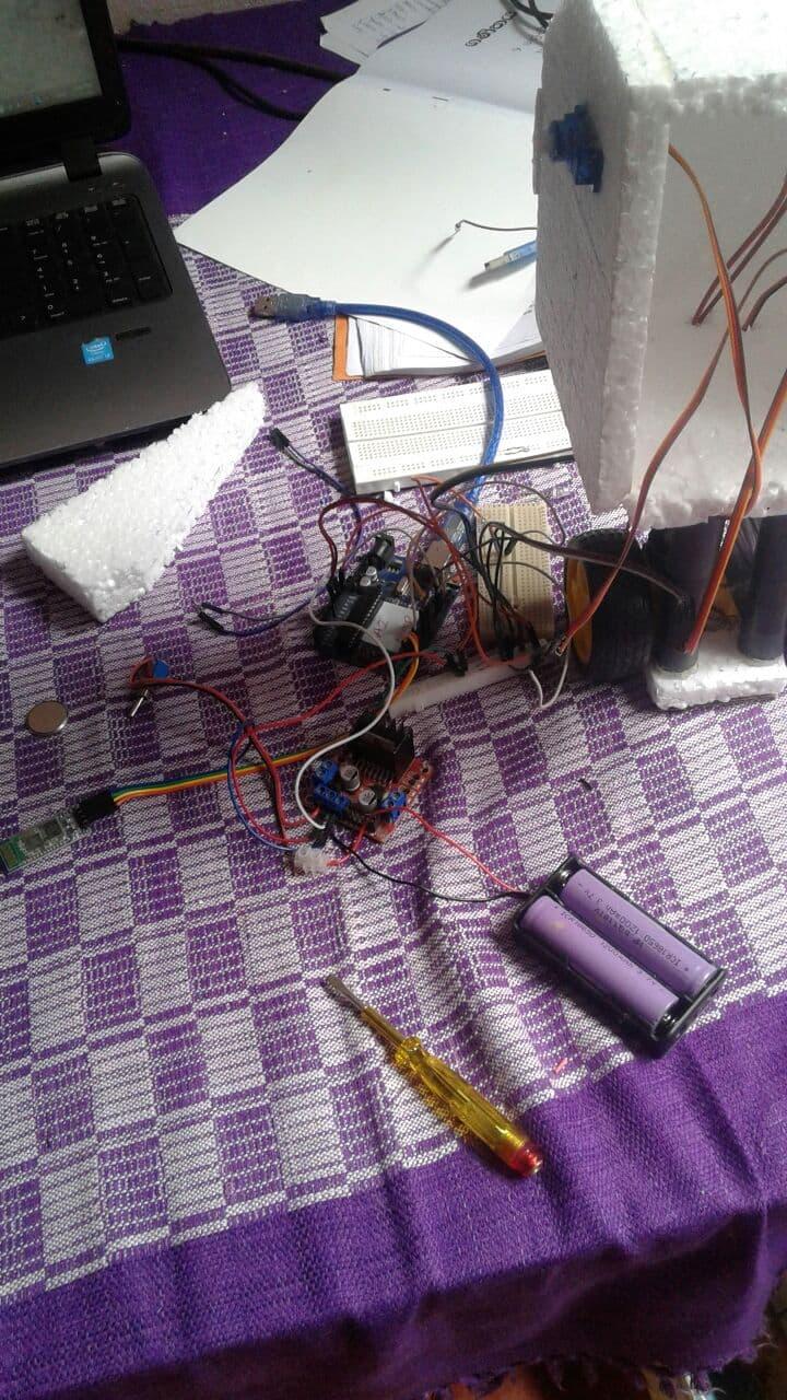

Step 1: CREATING THE CHASSIS
I used foam board to make the chassis,
After,I drew and cut parts ,I fixed them with tooth picks and got the shape
Next I paste them out
after pasting I pour plaster of paris to strong
after all things I painted it

Step 3: Bluetooth Controller
I used BLUETOOTH ELECTONICS (https://play.google.com/store/apps/details?id=com....)app to bild the platform
HC 06 as the receiver to arduino nano
Step 4: SERVO MOUNT
three servo as head, right arm, left arm
Step 5: CIRCUIT AND PROGRAMME

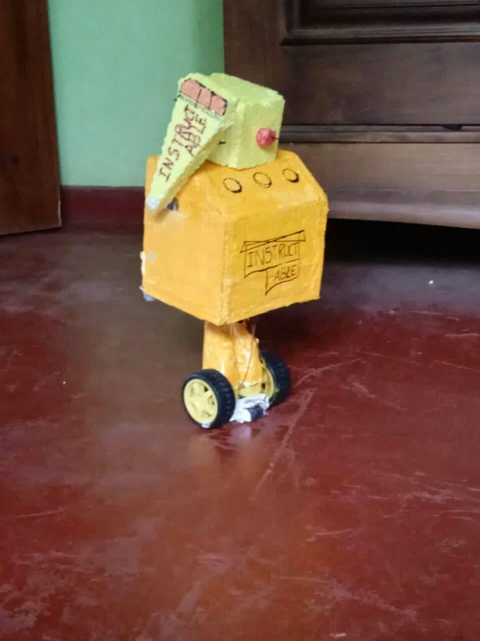

Step 6: FINISHED
IT CAN SALUTE
IT CAN MOVE
IT CAN CLEAN WITH UV
IT HAVE LIGHTS
IT CAN ROTATE HEAD
IT CAN ARM MOVE
