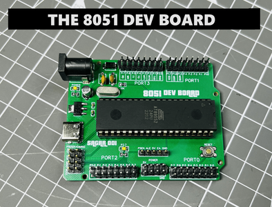

We need an activation circuit to program this microcontroller, which contains a reset circuit, programming headers, crystal oscillator and some loading capacitors. That is known as minimal system required for a microcontroller, still there are some issues remain which has to be resolved like power supply, headers for I/O and programming pins. So, I designed a development board rather than making a minimal system. Which allows to directly connect the peripheral on I/O ports of the microcontroller. I took inspiration from Arduino UNO and designed a PCB with all the controls on it, the programming headers are placed on one header, and all the 4 ports have dual headers. I also designed the power section with some capacitor, Dc jack and linear voltage regulator on the same board.
Step 4: Circuit Diagram:
8051 required a pull up resistor on reset pin which is used to perform all the operation and this pin never kept floating, and a tactile switch is added to pull down the reset pin to Reset the overall microcontroller and to resume the operation from beginning. I am using a 12MHz capacitor with 33pF loading capacitors as mentioned in the datasheet, the loading capacitor is used to tune the crystal frequency precisely over the PCB impedance. In the power section I am using a linear voltage regulator AMS1117 5V @1A which supplies 5V to the whole microcontroller and headers. Some coupling capacitors are added with it, to remove any transient produced in the power supply (basically smoothen out the DC voltage noise).
There are two power supply sources, 1st 12v barrel jack and 2nd the type C USB. Both will allow the power input, USB interface is just used as a power supply source here not for programming. Two onboard status LEDs are there one for the power supply and second to test the blink program for 1st time programming testing, The blink LED is connected to port 2 pin 7. Two extra headers are there, one for controlling the operations(U7) and another one to program the microcontroller (H2). Controlling sections have control on switching of ROM(external/internal), Data and address bus multiplexing control and control on program status. Programming headers are utilizing the SPI interface to connect with the microcontroller.

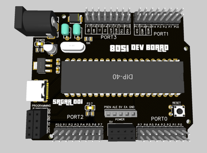

Step 5: PCB Design:
As I have mentioned before, I have taken inspiration from Arduino Uno. And designed the PCB according to that. Here I want to give one more hint that Arduino has built in 10 Bit ADC 6 channels that’s why it has separated Digital and Analog pins. But in case of 8051, there is no onboard or inbuilt ADC for analog operations, but we can connect an ADC or DAC on the digital pin by interfacing the external available ADC/DAC modules or ICs.
So, I enlarged the dimension a little and placed all the 4 ports accordingly. The pin configuration is mentioned on the PCB itself for the I/O. I placed the microcontroller in the middle with the clock circuit as near as possible to the microcontroller. Then I placed the power section on the one side of the microcontroller with a coupling capacitor near to the DC input and linear voltage regulators. For better DC power supply design coupling capacitors of different values can be placed to eliminate the HF(high frequency) noise. Download all the required files from here, Gerber, BOM, CPL and schematics.

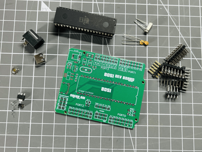

Step 6: Assembly Instructions:
The PCB has SMT and DIP through components, I always recommend to first complete the placement and soldering of SMD components. Because assembling the SMT components by hand is really a very difficult task and needs a lot of space to be placed precisely. Only a person with better soldering skills can assemble the SMT components with a hand soldering method. By the way there is one more way to do it professionally, NextPCB is providing SMT assembly and PCBA assembly service worldwide, and the cool thing is that the first 5PCS of PCB assembly is free. You can explore the free assembly process from here. Sign-up now using this link to get free assembly on your PCB boards.

To first power on by giving supply to the microcontroller some steps are mandatory to perform, take a multimeter in continuity mode and check the continuity of ports, power rails and capacitors. If there is any short in the power supply then the microcontroller may fail. Usually 3rd party microcontrollers are cheap and do not have a protection circuit. Then check the 5V output from the power supply without plugging the microcontroller. If everything is OK, plug the microcontroller in and upload the first blink sketch. On the first time plug, if everything is fine, the onboard led will glow and which is indication of power supply working.
