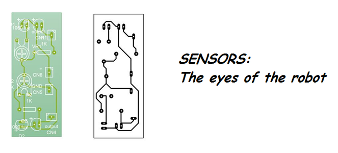

Step 5: SENSORS: the Eyes..
sensors are most important part of LINE TRACER..
here i used IR LED as transmitter and PHOTODIODE as receiver. u can also use bright red or white led but IR led increases the accuracy of sensor unit..
for details and READY MADE SENSOR BOARD DESIGN CLICK:https://www.instructables.com/files/orig/FIM/ZXX5/GZYCFV1I/FIMZXX5GZYCFV1I.png
