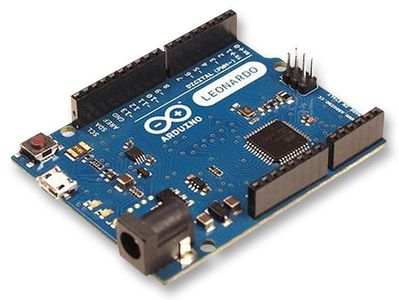

The Arduino Leonardo is used because it can act as a native USB MIDI device, making it easier to communicate with music software.

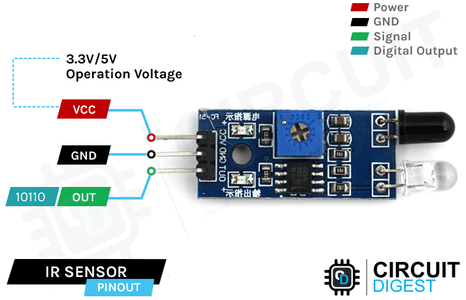

  2. 10 IR Sensors (To detect finger movement)

The IR sensors are connected to different digital pins of the Arduino Leonardo. Each sensor outputs a HIGH or LOW signal based on whether a finger is present, and the Arduino translates this into MIDI note signals.
