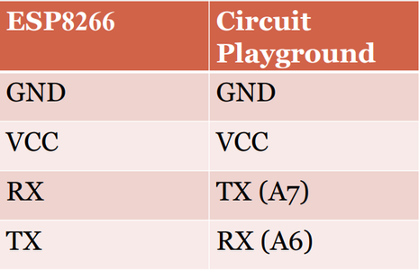

  5. Connect the CPX and ESP8266 boards together using jumper wires. Connect the following pins:
  • CPX GND to ESP8266 GND
  • CPX RX to ESP8266 TX (A7)
  • CPX TX to ESP8266 RX (A6)

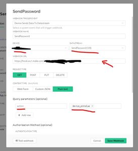

Step 5: Building the First Blynk Device - "connector Blynk"
  1. To begin, we will create a new template called "Connector Blynk".
  2. Next, we will navigate to the "Datastreams" window and create 6 new datastreams, the 6 datastreams that are shown in the picture (all of them are virtuals pins).
  3. Once the datastreams have been created, we will move to the "Automation" window inside the template to define the appropriate condition for each datastream based on the image.
  4. After setting the conditions, we will save the template and navigate to the "Automations" window located in the toolbar on the left side of the page.
  5. From there, we will create three new automations, each corresponding to its respective image.
  6. Moving on to the "Search" window, we will create a new device from the tempalte we have created and save.

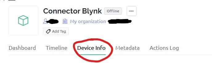

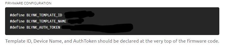

  7. Go to "Device Info" and copy the BLYNK_TEMPLATE_ID, BLYNK_TEMPLATE_NAME, and BLYNK_AUTH_TOKEN, we will need this in the next steps.

  1. Head over to your "Connector Blynk" device in Blynk and locate the "device info" section. Copy the BLYNK_TEMPLATE_ID, BLYNK_TEMPLATE_NAME, and BLYNK_AUTH_TOKEN and paste them into the appropriate spots in the code.

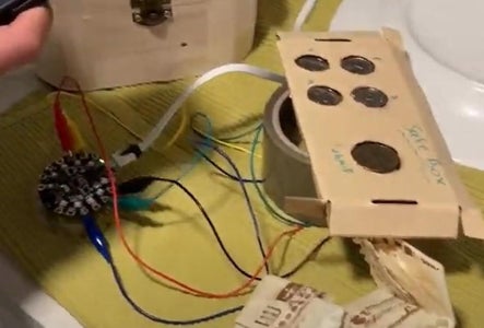

Before we get started, let's gather all the components we'll need: a box, 5 coins, foil, duct tape, scissors, markers, and a pencil.
Next, we'll need to determine where to place the "buttons" on the box. To do this, take your 5 coins and position them on the box. Use a pencil to mark the location of each coin.
Using scissors, carefully cut holes in the top of the box according to the marked circles. Remember to only cut the top part of the box, just like in the picture. On the opposite side of the box, cut a small hole as shown.
Now, cut 5 pieces of foil that are around 3 centimeters long and 5-6 centimeters wide. Fold each piece until it's 3 centimeters long and 1 centimeters wide (This will make them thicker and easier to attach to the coins.). Then, attach each piece of foil to a coin using duct tape.
Place each coin into the corresponding hole on the box and pass the pieces of foil through the small hole you cut earlier.
Next, use a marker to draw a number next to each coin to signify the value it represents. Choose one coin to serve as the SUBMIT button.
Finally, attach a crocodile clip to each piece of foil, which will later be connected to CPX3.
Keep in mind that by using 5 coins, you can create a password consisting of 4 predetermined numbers (one of which must be the submit button). If you want to increase the number of possible characters in the password, you can add additional coins. You can even use characters other than numbers, like letters or other keyboard inputs. However, if you do this, you'll need to make a few changes to your CPX3 code (we'll cover that later).

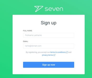

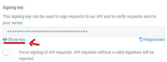

Step 9: Creating SMS77 Account
To get started, go to https://app.seven.io/ and sign up for an account.
After signing up, make sure to verify your email address.
Now, enter your password and log in to your account.
In the toolbar at the top of the screen, click on "Developer."
Next, in the API keys segment, click on the settings button.
Click on "Show Key" and then click on the key to copy it. We'll need this key later, so make sure to keep it handy!

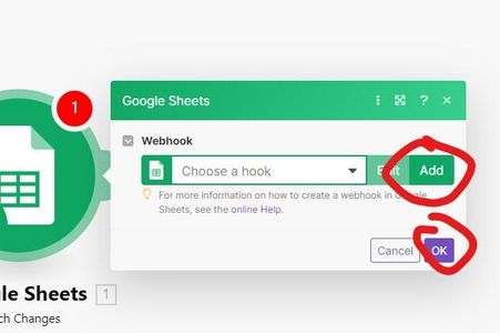

Step 14: Creating Our 1st Scenario in Integromat - Google Sheet Scenario

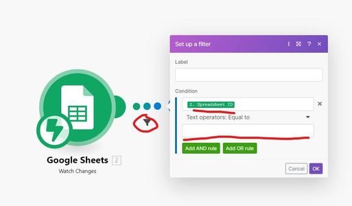

First, look for the big plus sign in the middle of the screen and click on it. Then, search for "Google Sheets" and select it from the options. Then, select "Watch Changes".
Click on the Google Sheets moudle, simply click on "add", "save", and "ok" to confirm your choice.
Next, let's add another module to our scenario. Look for the "Add another module" button and click on it. From there, search for "HTTP" and choose it.
Click on the gear icon between the two modules. Then, select the option to set up a new filter. Under the condition field, choose "Spreadsheet ID". In the next field, paste the spreadsheet ID that you copied in step 11.
Lastly, make sure to save your scenario. We'll be coming back to it later on. Great work so far!

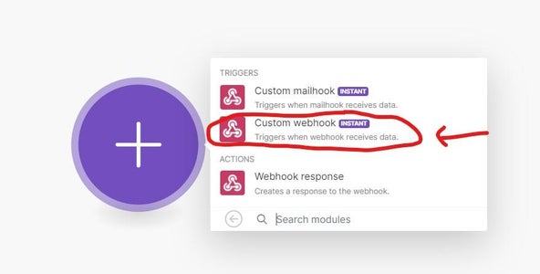

  1. Go to your Integromat account and open a new scenario.

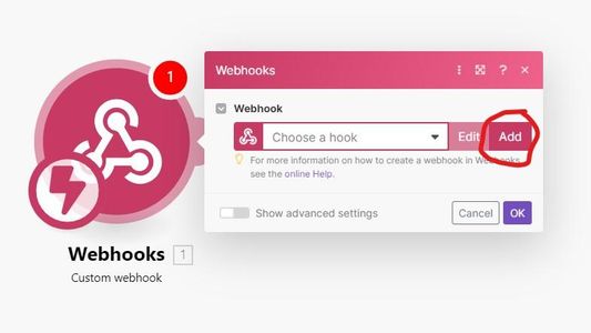

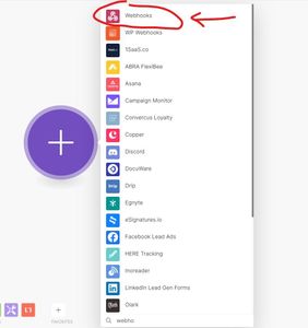

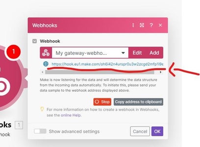

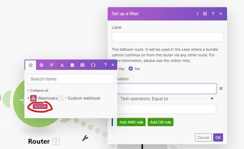

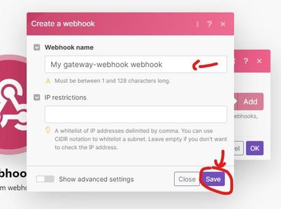

  2. Click on the big plus sign in the middle of the screen and search for "Webhooks." Choose "Custom Webhook" and click on "Add."
  3. Give your webhook a name and click on "Save."
  4. Copy the blue link that appears and open a new tab in your browser.

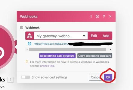

  5. Paste the link into the address bar and add "?action=1" to the end of it. Press "Enter."
  6. Go back to your Integromat scenario and click "OK."

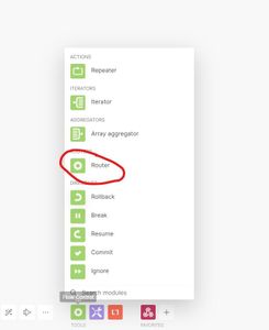

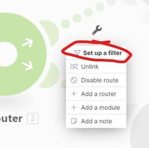

  7. Click on "Tools" and choose "Router."

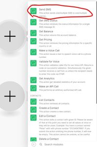

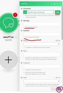

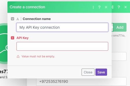

  8. Click on the router, and two new plus signs will appear. Click on the upper plus sign and search for the "SMS77" module. Choose "Send SMS" and click on "Add."
  9. Paste your API key from step 9 into the appropriate field.
  10. Insert the required message and the recipient's phone number, then click "OK."

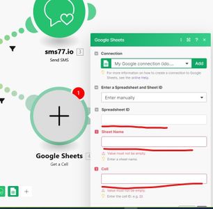

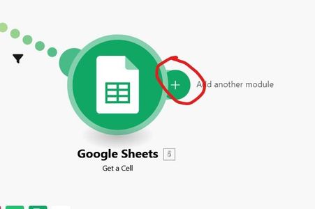

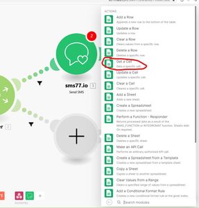

  11. Click on the lower plus sign and search for the "Google Sheets" module. Choose "Get a Cell."
  12. Fill in the details with the spreadsheet ID and name from step 11, and in the "Cell" field, type "B2."

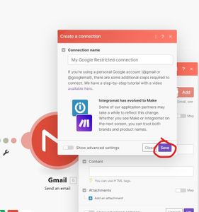

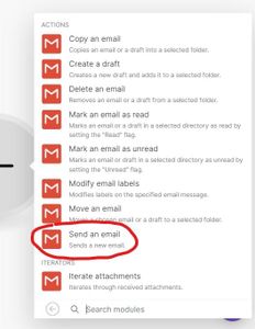

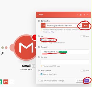

  13. Click on the "Add a new module" button and search for the "Gmail" module. Choose "Send an email."
  14. Click "Add" and choose the Google account you worked with in step 10.
  15. Press "Add a recipient" and fill in the email address you want the email to be sent to.
  16. In the subject field, type "The password is: {{5.value}}."
  17. Click "OK" and save the scenario.

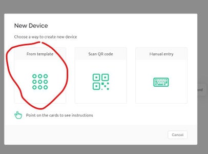

Once that's done, let's head over to the "Search" window and create a new device using the template we just created. Be sure to save your changes!

Once you've made the necessary changes to the code, upload it to the CPX. Then, connect the 5 crocodile clips from the Safe Box to the CPX, making sure to attach each crocodile clip to the correct pin in the CPX. In our code, we connected it like this:
  • The button that represents 1 is connected to pin #6
  • The button that represents 2 is connected to pin #9
  • The button that represents 3 is connected to pin #2
  • The button that represents 4 is connected to pin #3
  • The button that represents SUBMIT is connected to pin #10
You can connect them however you want, just make sure to change your code accordingly.
For example, if you want to connect pin #10 to the button that represents the number 3, your "if" statement should look like this:
if(CircuitPlayground.readCap(10) > 1000) // If the button that represents 3 was pressed
input = input + "3"; // Add 1 to the current input
for(int i=0; i<10; i++) // Go over all the newPixels
CircuitPlayground.setPixelColor(i, 255, 255, 255); // Color the current neoPixel white.
delay(300);
CircuitPlayground.clearPixels(); // Turn off all the neoPixels.
Finally, after connecting all the crocodile clips, connect the CPX to a power source (such as a portable charger, batteries, or a computer), and you're all set!

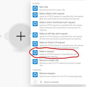

In the HTTP module, insert the following link in the URL field:
https://sgp1.blynk.cloud/external/api/update?token={YOUR_TOKEN}&V7={{2.rowValues[].`1`}}
Be sure to replace {YOUR_TOKEN} with your CPX3 Blynk device token.
Under the "Parse response" section, select "yes" and click "OK" to confirm your changes.
Finally, turn on the scenario and you're all set!
