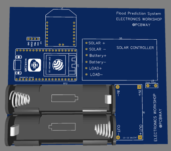

Step 4: Schematic Diagram
Step 5: Order Directly From PCB WAY
I have already uploaded all these required manufacturing files in PCBWAY website. You can easily go to the below link and place you order, and get your Own Home Automation PCB manufactured from one of the best pcb manufacturer PCBWAY
ORDER IT DIRECTLY FROM PCBWAY*******
