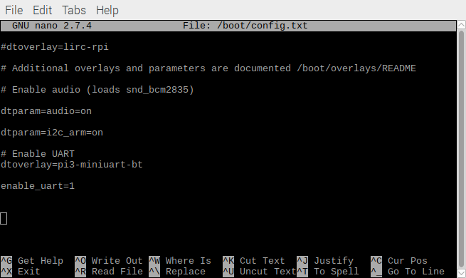

- Open up terminal and type
- $ sudo nano /boot/config.txt
- add the following to the file
- enable_uart=1
dtoverlay=pi-miniuart-bt
- Save the file use ctrl-x then y and enter.

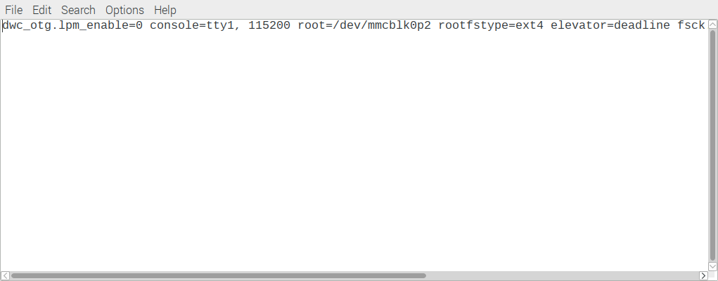

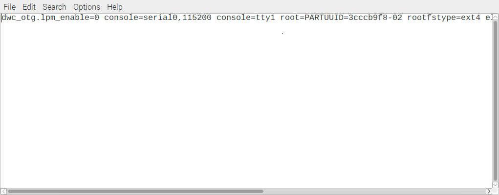

- Next open up the cmdline.txt file using the following command.
- $ sudo nano /boot/cmdline.txt
- Modify the file so the contents are the same as the second line.:
dwc_otg.lpm_enable=0 console=serial0,115200 console=tty1 root=/dev/mmcblk0p2 rootfstype=ext4 elevator=deadline rootwait
dwc_otg.lpm_enable=0 console=tty1 root=/dev/mmcblk0p2 rootfstype=ext4 elevator=deadline rootwait
- Now reboot the system
- Once you have rebooted the UART bus should be enabled.

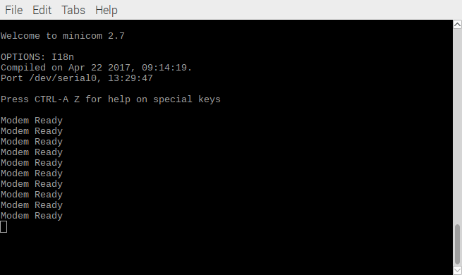

- To test this use:
- $ sudo apt-get install minicom
- $ minicom -D /dev/serial0
Depending on you version of Raspbian your UART port will either be ttyAMA0, ttyS0 or serial0. If you are using Rasbian stretch it will be serial0.
- You should see modem ready continuously repeated.

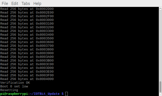

Step 8: Updating Firmware
This step is required since there has been a new update recently. Once UART has been enabled we are ready to upload the new firmware. ATTENTION, It is important at this stage, before continuing, to power the IoT Bit and the Raspberry Pi independently to do this step.
Navigate to the IOTBit-GSM_Firmware_Update folder you can download it from https://github.com/Altitude-Tech/IOTBit_GSM
Using terminal do:
$ cd ~/IOTBit-GSM_Firmware_Update
$ sudo python Firmware_Updater_IOT.py
The script will ask you for the serial port if you are using Raspbian stretch and above you can input /dev/serial0
If the upload is successful the program will write and read from multiple memory addresses then say verification ok
