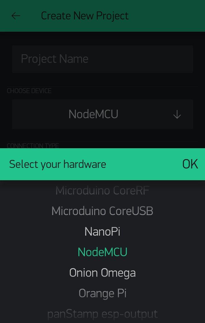

Step 1: Setting Up Blynk App
open up the Blynk app and click on new project then select the board type as nodemcu and then an auth token will be sent to your email, and then select the widget ZERGBA AND THE SELECT R PIN AS D0, G PIN AS D1,AND B PIN AS D2 .
