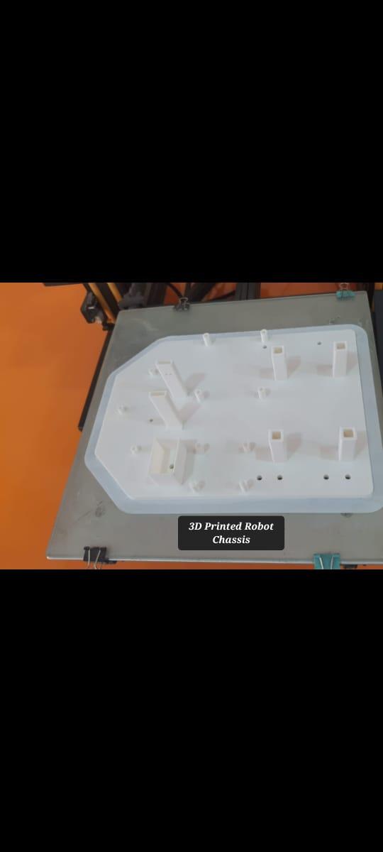

Step 1: Designing the Robot Chassis
Before starting any Project that involves Building of the Chassis from scratch such as a 3D Printed Chassis it is necessary to first create a simulated version of the same by taking accurate dimensions of all the components required and thus the dimensions of the overall Chassis.
In order to achieve this functionality AUTODESK brings to us a great CAD Designing Software FUSION 360.
By making use of this software we able to create real world objects in an Emulated environment by taking actual dimensions of that object so as to design our final product accordingly.
The Chassis made is completely designed in the FUSION 360 software by taking accurate dimensions and measurements and is then feed to the CURA Software which in turn generates a g-code for the respective 3D printer and the Chassis is thus developed.
The whole of the Designing process could be achieved in just 2 simple steps :
CAD Design :
Step 1 :
- We firstly design all the electronic components required as per our project.
- Now instead of designing every component from scratch we could also import some of the components such as the RasPi Board , Camera Module , L293D , etc. from GrabCAD. https://grabcad.com
- Make sure that all the components that you import or design should exactly match with your real world objects.
Step 2 :
- Once all the Components are accurately designed we can now further move on towards our Chassis Designing.
- In order to know the Chassis Dimensions we firstly need to arrange all our components and other peripheral parts sparingly and in an orderly manner so as to ensure space efficiency and component placing complexity.
- Once all the components are placed exactly as desired sketch a chassis accordingly and export it as a one body for the final 3D print.
I have added all the CAD Files. For Viewing all the files on your local machine open all the files onto your Fusion 360 software. The file named 'Robot Chassis' is the Chassis of the Robot.
The 'Robot Chassis' is actually the chassis which is to be printed and feed to the 3D Printer.The all other step files are the files containing the CAD designs of the respective individual components.
Due to the file size upload restrictions I was not able to upload the actual file of the final robot but I will paste the browser link of the final robot CAD below. You can download the same from there.
Link to access the Final Robot CAD : https://a360.co/3mgwzuc
Link to access the Robot Chassis CAD : https://a360.co/3xk2sYU

Step 2: Assembling the Robot
Now its time to get some Hands On.....!!!
We now bring together all the components and all the Hardware parts required for our Bot and place them as per our final CAD Model, accordingly.
Below are all the Steps mentioned from Scratch after your 3D Printed Chassis is Ready.
Lets Assemble!!!
Step 3: Mechanical Locomotive Assembly
The whole of the Assembly part could be further divided into 3 simple Parts :
- The Mechanical Locomotion Assembly
- The Electronic Components Assembly
- The Circuit Connections
We firstly start off with the Mechanical part as per the order mentioned above........
Step 4: The Motor Mounts
- Fix the Motor Mounts using Nuts and Bolts as mentioned in the Supplies (M4).
- Take care that the Bolts chosen should be of considerable length as it should not obstruct between the Ground and the Chassis while Motion.
- Also care should be taken to use flat top Bolts as the DC Hobby Geared Motors are to be mounted on the motor mounts which need to mounted without any hinderance from the Bolts.
Step 5: Mounting the Motors
- Fit both the DC Motors using Nuts and Bolts onto the Motor Mountings.
- Care to be taken while attaching the Left and the Right motors according to the Hub Direction of both the Motors.
Step 6: Attaching the Rear Wheels
- Attach Both the wheels using small sized screws.
- Note that the screw length and width should be enough so that there is no slipping or Relative Motion between the motor hub and the attached wheel.
Step 7: Mounting the Caster Wheel
- Fix the 360 degree rotating Caster Wheel along the Three Triangular Holes drilled across the Front Side of the Chassis.
- The Height of the Caster wheel could be adjusted easily by using the two Nuts and one Bolt Mechanism on all the three Bolts Fitted.
With this our Basic Mechanical Locomotion Part is Ready!!!
