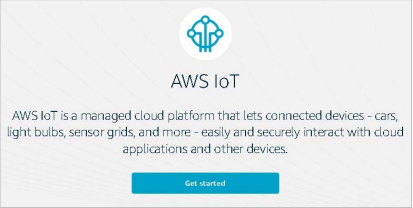

Step 4: AWS IOT Setup
Sign in with your AWS console at https://aws.amazon.com
In the AWS dashboard, type “AWS IoT” to access the AWS IoT service.
On the Welcome page, choose Get started
Now register your Raspberry PI as a Thing In the left navigation pane, click “Registry” to expand it, then choose “Things”
On the page that says “You don’t have any things yet”, choose “Register a thing” If you have created a thing before, choose Create.
A thing represents a device whose status or data is stored in the AWS cloud. The Thing Shadows is the state of the device, e.g. is it “on” or “off”, is it “red” or “green” etc. Our “thing” here is our RPi, so let’s type “MyRaspberryPi” for the name Click “Create thing”
On the Details page, choose Interact
Copy and paste the REST API endpoint into a Notepad. You will need this value later.
