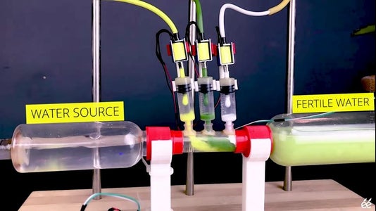

The mixing tank is filled with water through the solenoid valve. The peristaltic pumps dose the tank with the required amount of fertilizer and then the mixer pump is turned off. The mixture drains into the growing media under gravity

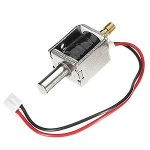

Step 6: Solenoid Valve
How Does a Solenoid Valve Work?
A solenoid is a device that converts electrical energy into mechanical energy. It has a coil wound over a conductive material, this set-up acts as an electromagnet. The advantage of an electromagnet over natural magnet is that it can be turned on or off when required by energizing the coil. Thus when the coil is energized then according to faradays law the current-carrying conductor has a magnetic field around it, since the conductor is a coil the magnetic field is strong enough to magnetize the material and create a linear motion.
Projects with Arduino or other microcontroller platforms where it is necessary to activate something through a solenoid.

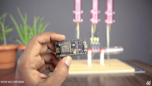

Step 7: NodeMCU
NodeMCU is an open-source LUA based firmware developed for the ESP8266 wifi chip. By exploring functionality with the ESP8266 chip, NodeMCU firmware comes with the ESP8266 Development board/kit i.e. NodeMCU Development board.

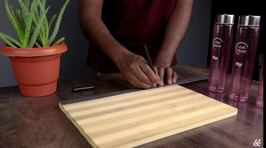

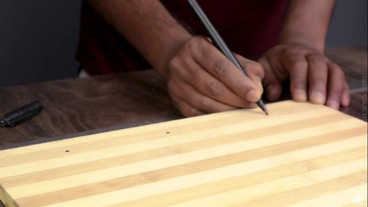

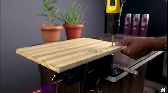

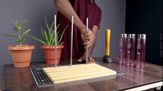

Step 9: Make Supporting Frame
we use 1ft wood board for supporting frame
Drill hole in MDF board keeping in mind about distance between bottles as show above image

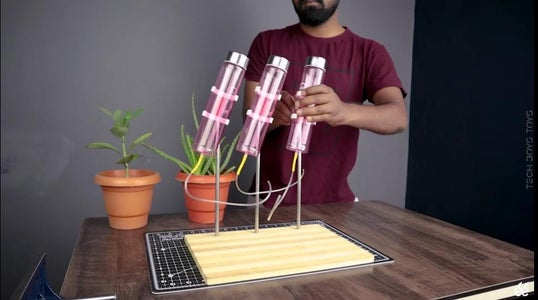

Step 10: Attach the Bottle With Support Rod
To make stand support I will be piercing 3 support rod structures into our wooden board
i use Three plastic bottle as the mixing tank, aluminum won't work for this project so better prefer to use plastic bottle because plastic bottle are visible so i check the inside material

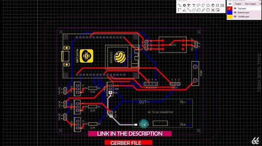

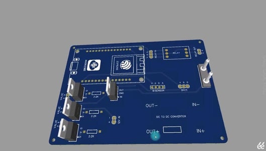

Step 12: Circuit Diagram
As you can see, I have made these circuits on zero PCB by myself, if you do not want to make it then there is no problem, you can download the gerber file from here that you can order it from any PCB manufacturer.
but I highly recommend you to order from NextPCB
NextPCB is one of the famous PCB manufacturer in china
NextPCB offers you get free PCB assembly in 0 Dollars.PCB board manufacturer
Nextpcb.com

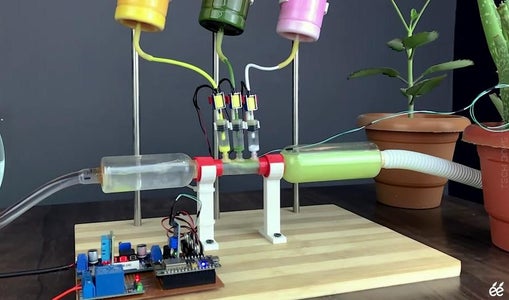

Step 13: Final Assembly of All Components
use your own ideology to connect this tube from plastic bottle to input 12 of DC power water pump Motors
I will be using aquarium pump for water supply

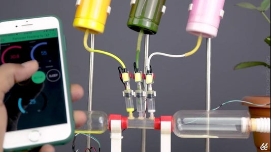

Now fill each of these 3 containers with nitrogen fertilizers , Phosphorus fertilizers and potassium fertilizers.
Step 14: Final Output
Three bottles of chemical are used to feed the plants.
A 2 liter bottle was used as the mixing tank. The float switch fills the tank with about 2 liters of water and the submersible pump is used to mix everything. Chemicals are pumped into the tank through the clear tubes.

  • You can control your device staying anywhere in the world through the Blynk apk in your phone

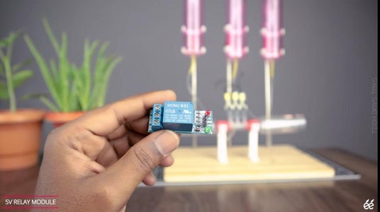

As discussed at introduction, our final goal here is to take care of a plantation. With the data provide by sensors, we will know the air and soil temperature, air relative humidity and the most important how "dry" is the soil. With those data in hand, our program should calculate if would be necessary to irrigate the plantation, turning on a water pump or to turn on an electric lamp to provide the appropriate heat to the crop. For that, we will use a small dual 5V Relay Module for Pump and Lamp activation.
