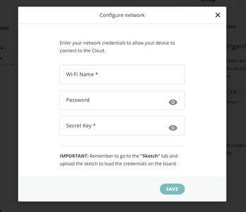

Step 7: WIFI
  • configure the WIFI under network
  • Fill your Wi-Fi- name and password
  • Copy paste the secret-key saved earlier
