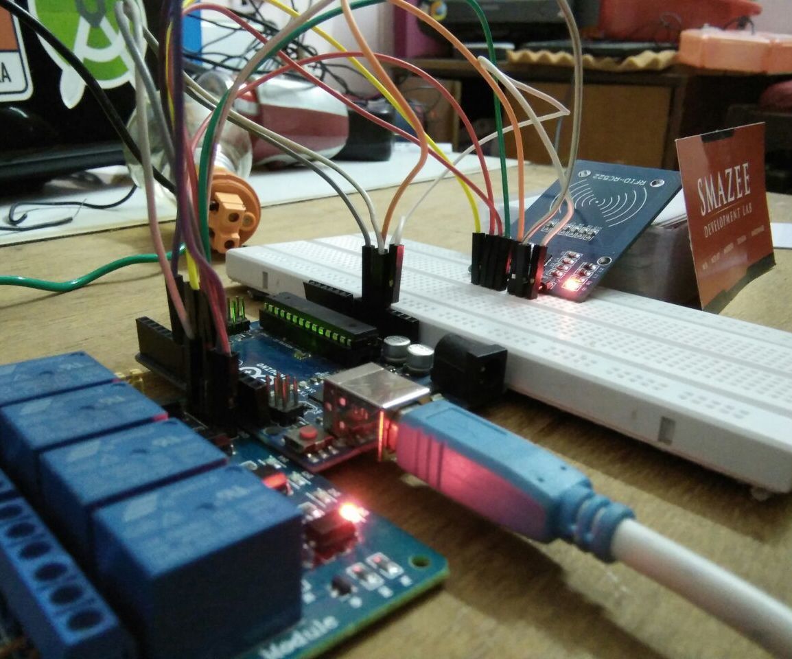

Step 2: ESP 8266 and Ultrasonic Sensor Connection
The Above Image will Clearly explain the Connections For The ESP 8266 and Ultrasonic Sensor with Arduino .
