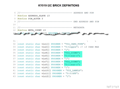

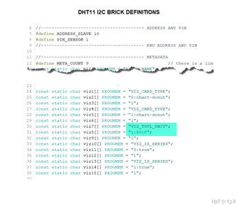

Step 5: Metadata Customization
Due to the amount of possible customizations, each slave has its own metadata modification file. The files are to be in the format user_metas_.json.
The slave address is found in the definitions.h file in the ATTINY85 sketches:
#define ADDRESS_SLAVE XX
The metadata is defined in the same file like this:
const static char viz1[] PROGMEM = "VIZ_CARD_TYPE"; const static char viz2[] PROGMEM = "2:chart-donut"; const static char viz3[] PROGMEM = "1";
The first line is the name of the metadata item.
The second line is the value. It generally has a property index suffix.
The third line is the continuation flag. 1 - continue, 0 - end of metadata (VCC_MV).
Browse to the root of the webserver (shown in the console output like http://192.168.8.104/).
EDITING
In the ACE EDITOR choose config/user_metas_SLAVE_ADDRESS.json (or upload one). The structure is:
- An array of name/value pairs.
- Name is name of the metadata item to change.
- Value is the change. The index suffix is checked for the replacement.

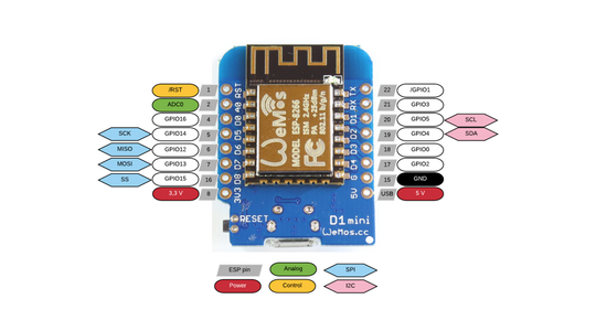

Step 7: MCU Preparation
In this build we are using the Wemos D1 Mini. If you have previously built a D1M WIFI BLOCK, you can use that for the modular hardware component. If not, as a bare minimum follow the next section.
SOLDERING THE HEADER PINS ON THE MCU (using the PIN JIG)
If you cant print a PIN JIG just follow the instructions and improvise: the height (offset) of the PIN JIG is 6.5mm.

Step 8: MCU Housing Preparation
The MCU Housing exposes headers for the D1 Mini to plug into and headers for daughter-boards that communicate with the Socket (sensors and actors) circuit.
HOUSING HEADERS
This is based on a D1 Mini Protoboard, and breaks out these pins:
- Pins for the D1M WIFI BLOCK/D1 Mini to connect to.
- Direct Breakouts of the 2 rows of contacts from the D1M WIFI BLOCK/D1 Mini. These are only available for convenience whilst prototyping. It is expected the daughter-boards will block all access to these headers.
- 4 Breakouts of the specific pins used by the daughter-boards.
