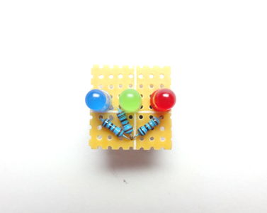

    Step 3: Assembling the Indicators
    The indicators are meant to be fully customizable. It is the event signals from the main circuit that are seen as Heartbeats. For this build we will use LED indicators; your build can use relays (yes the VCC is broken out) or another visual/signal based indicator. The resistor values will depend on personal preference on how bright you want them.
    1. On the top, insert a blue LED into RED1 (+) and BLACK1 (G), and solder on bottom.
    2. On the bottom, bend the lead from RED1 so it touches the copper pad on SILVER8 and trim.
    3. On the bottom, trim lead from BLACK1 above solder.
    4. On the top, insert a green LED into RED2 (+) and BLACK2 (G), and solder on bottom.
    5. On the bottom, bend the lead from RED2 so it touches the copper pad on SILVER9 and trim.
    6. On the bottom, trim lead from BLACK2 above solder.
    7. On the top, insert a red LED into RED3 (+) and BLACK3 (G), and solder on bottom.
    8. On the bottom, bend the lead from RED3 so it touches the copper pad on SILVER10 and trim.
    9. On the bottom, trim lead from BLACK3 above solder.
    10. On the top, insert a 1K resistor into through-holes SILVER1 and SILVER4.
    11. On the bottom, trace, trim and solder lead from SILVER1 onto BLACK1.
    12. On the top, insert a 1K resistor into through-holes SILVER2 and SILVER4.
    13. On the bottom, trace, trim and solder lead from SILVER2 onto BLACK2.
    14. On the top, insert a 1K resistor into through-holes SILVER3 and SILVER4.
    15. On the bottom, trace, trim and solder lead from SILVER3 onto BLACK3.
    16. On the bottom, solder wires on SILVER4 and trim at about 5mm extending.
    17. On the bottom, solder a black wire onto SILVER4.
    18. On the bottom, solder a white wire into SILVER5, ensuring continuity to lead from RED1.
    19. On the bottom, solder a yellow wire into SILVER6, ensuring continuity to lead from RED2.
    20. On the bottom, solder a orange wire into SILVER7, ensuring continuity to lead from RED3.
