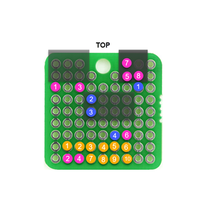

Step 4: Protoboard Assembly
There are a few occasions where soldering on the other side of a through hole is obstructed. When this is the case, I soldered a dob on the target through hole, then from the side melt the solder and push the exposed hookup wire into center hole, hold and remove heat.
- From the bottom, insert pins from 2P connector in RED1 & RED2 with opening to outside. Solder pins off on topside.
- From the bottom, insert pins from 3P connector in RED3, RED4 & RED5 with opening to outside. Solder pins off on topside.
- From the bottom, insert pins from ATTINY85 in RED6 - RED13 with chip marker as shown. Solder pins off on topside.
- From the bottom, solder a blue wire from YELLOW1 to YELLOW2.
From the bottom, solder a green wire from YELLOW3 to YELLOW4.
- On the top, solder a black wire from RED1 to RED4.
- On the top, solder a black wire from BLUE1 to BLUE2.
- On the top, solder a black wire from BLUE3 to BLUE4.
On the top, solder a red wire from PINK1 to PINK2 (leaving plenty of excess wire as shown).
On the top, solder a red wire from PINK3 to PINK4 (leaving plenty of excess wire as shown).
On the top, solder a red wire from PINK5 to PINK6.
On the top, solder a red wire into PINK7 (leaving plenty of excess).
On the top, solder a black wire into PINK8 (leaving plenty of excess).
Solder 6P male headers onto the INA219 module as shown.
From the top, insert the INA219 pins into ORANGE1 - ORANGE6 and solder.
Solder 4P male headers onto the OLED module as shown.
Remove the plastic collar from the 6P pins.
Bend the pins into a slight S shape, dry fit to check boards are parallel.
From the top, insert the OLED pins into ORANGE7 - ORANGE10 and solder.

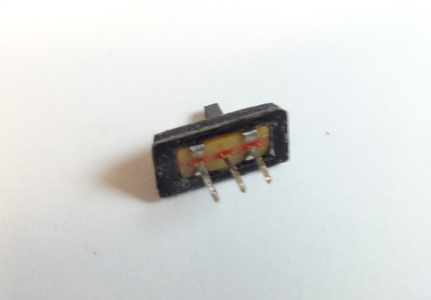

- Assemble SPDT with 3D printed switch surround, with Cyanoacrylate on contacting surfaces.
- Tin pins on SPDT.
- Fasten switch assembly to casing with Cyanoacrylate.

Solder loose red wire from protoboard to middle pin on SPDT switch.
Solder a red wire from +ve pin on battery holder to bottom SPDT pin (closest to large opening on casing).
