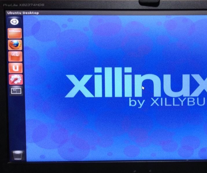

Introduction: IPSec Using OpenSwan on Zybo
Openswan is an IPsec implementation for Linux. It has support for most of the extensions (RFC + IETF drafts) related to IPsec, including IKEv2, X.509 Digital Certificates, NAT Traversal, and many others.
Before starting this tutorial you have to complete first tutorial in which is explained how to install Xillinux on Zybo.
