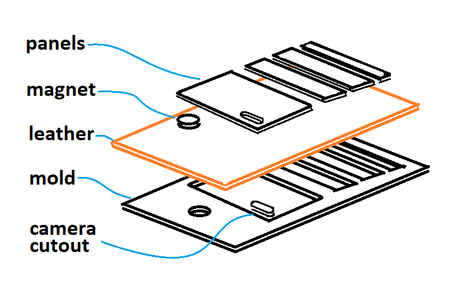

Step 1: Print Wet Molds
3D print these models, and use a soldering iron, or epoxy to fuse them together.
make sure the joints are smooth and even, as the leather will pick up any topology you have on them.
Step 2: Wet Mold the Leather
Dampen your hide with water. I wouldn't recommend soaking leather this thin since its quite delicate, and the dyes may bleed out. I used a spray bottle with water and misted it, rubbed it in, misted some more until i could *barely* see moisture come through on the top grain side.
Next, lay a piece of aluminum foil down on a board large enough for the 3D printed mold, followed by the mold, and then the damp hide - top grain facing down. the foil is to protect the leather surface from any grit/discoloration it might pick up from the board.
Press the hide into the mold to get an idea where the impressions are, then place the 3D printed panels into the impressions. getting the camera cut out into place can be tricky. It can be a bit easier if you slide that corner off the edge of your work surface, get it in place from the underside, then slide everything back to center.
Cover the hide with paper towels, and a second board, then clamp the whole thing.
Allow it to sit for a few hours, then change the paper towel, and re-clamp. let it sit like this till the leather is completely dry (+/- over night at room temp). Maybe change the paper towel a few times over the course the evening.
