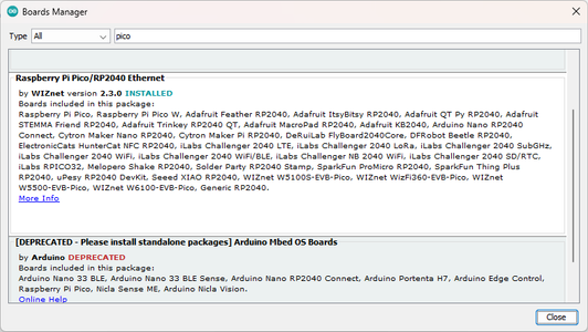

If you already installed arduino-pico, which WIZnet modified, you can update it to version 2.3.0 in Boards Manager. If not, please follow the below steps.

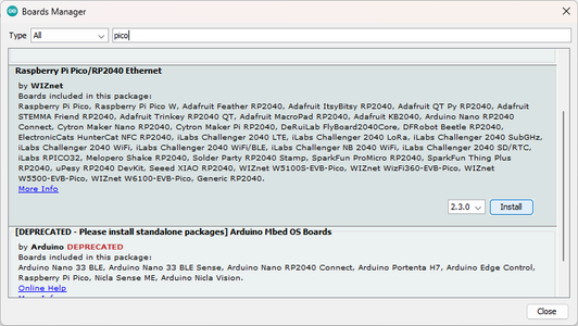

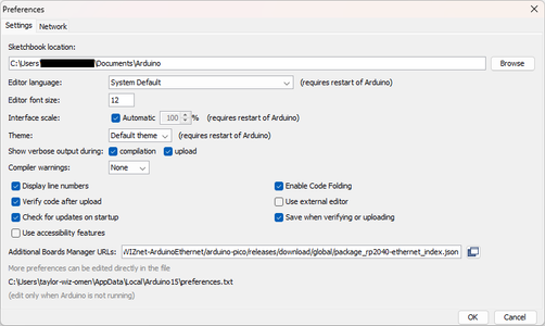

Step 2: Additional Boards Manager URLs
You can add the URL in the "Additional Boards Manager URLs" field and search pico or ethernet in Board Manager to add.
: https://github.com/WIZnet-ArduinoEthernet/arduino-pico/releases/download/global/package_rp2040-ethernet_index.json

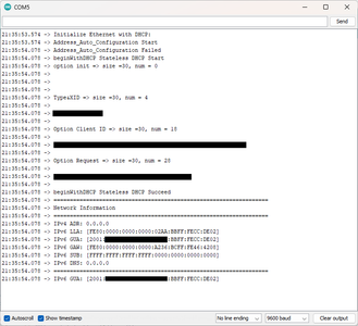

Step 6: Upload and Monitor
And Upload to the W6100-EVB-Pico. Maybe it is necessary to enter boot mode.
After choosing Port, then run a Serial Monitor.
You can see the allocated IP address.
If you have the IPv6 network, it is easy to use IPv6 by W6100-EVB-Pico.
