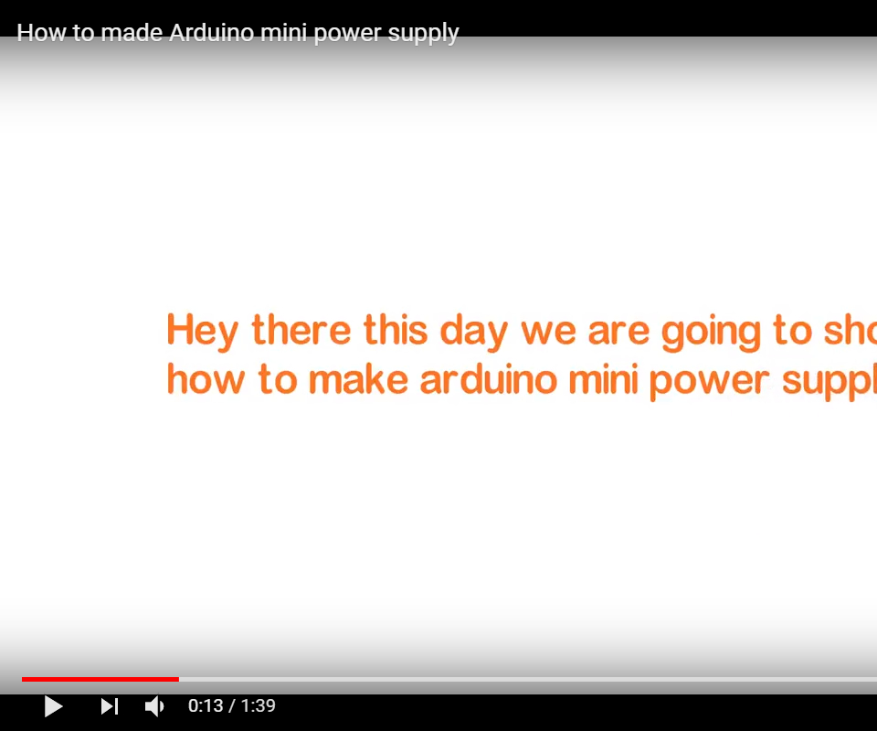

Step 1: Use 12 V 1 or 1.5 Amp Power Supply
Step 2: Make 12 V to 5 V Converter Circuit Component List
component list
