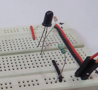

Step 5: Working With IR Receiver
The IR receiver looks similar to a LED which is tinted black. This has to be connected in opposite direction to the polarity or in technical term the receiver diode has to be reverse biased. In reverse biased condition receiver act as a water valve, depending on the intensity of IR light falls on the receiver the current flow through the receiver proportionally, just like the valve let the water flow as you open the valve (If no IR light is captured by the IR receiver there will be no current flowing).
We'll build a voltage divider using the receiver diode and a 10k resistor. This will help us get the voltage value and this voltage value is affected by the amount of infrared light that falls on it so, we can give this as an input to the comparator to decided the output. (If the IR reflection is more then the voltage across the receiver diode reduce (white surface) and when the IR reflection is less then the voltage across the receiver diode increases (black surface))

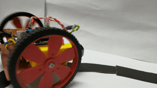

Step 8: Working of the Bot
Before moving with the bot replicate the sensor on both side of the PCB.
You might ask why the stroke with of the line is so large where it's technically just a rectangle and not a line anymore, that because the line should be able to completely absorb the IR light emitted by the IR transmitter LED so we can detect we are on the black surface.
When the line is between 2 sensors the bot runs both the motor and makes the bot move forward, but when any one of the sensor detects the black surface, the motor adjacent to the sensor is stopped and the other one continues to move forward. This motion gives turn to the bot and by doing this back and forth on both the motors the bot aligns itself on the line.

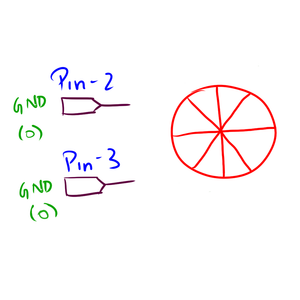

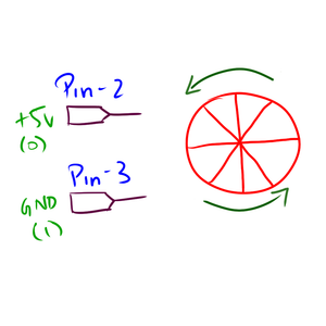

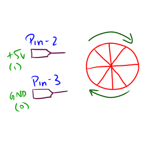

Step 9: How Does L293D Works?
We can't just connect the motors directly to sensors, just like we did with the output LED because the motors requires large current compared to an LED. So if we connect the motor to the sensor, it will destroy the circuit.
Therefore we need a motor driver, In this case I'm using a IC called L293D[datasheet].
With this IC we can control 2 motors (clockwise and anticlockwise direction) using just 4 pins.
- Pin 2 and Pin 7 to control one motor which is connected to pin 3 and pin 6.
- Pin 15 and Pin 10 to control the other motor which is connected to pin 11 and pin 14
When the input is '1'(HIGH) to pin 2 and '0'(LOW) to pin 7 the motor turns clockwise and when the input is '0'(LOW) to pin 2 and '1'(HIGH) to pin7 the motor turns in anticlockwise direction. But if the input to both the pins are same either 1(HIGH) 1(HIGH) or 0(LOW) 0(LOW) the motor stops spinning. This same logic is applicable for the other motor connected on the pin 14 and pin 11.

Step 12: Final Assembly
You can build a custom chassis to hold the motors and the circuit by 3d printing or by laser cutter, but to keep things simple I have used the PCB as part of the chassis for the bot and to have a better support I sandwich the motor between the PCB that we build and a copper clad of same dimension. To keep them attached I used some fasteners(bolts and nuts) and some hot glue. Once the body was done, I used a caster wheel as the support wheel for the bot. That's it, this concludes the assembly for the bot.

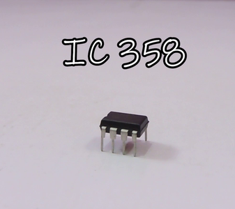

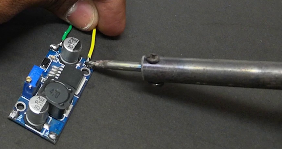

Step 13: Power Supply
You can just use a 9v battery for the power source as both IC 358 and IC L293D tolerant to that voltage.
But the issue with this method is the 9v battery exhaust very soon. So, I used a single 18650 Lithium Ion battery along with a boost convertor (convert 3.7v to 5v) to run this bot. Along with this you can use tp4056 to charge the battery or instead you can use the Lipo charger mentioned in the supplies to charge the battery externally.
