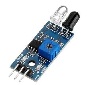

- IR Obstacle Avoidance Sensor

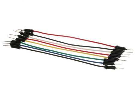

- Jumper wires

- Connect IR Obstacle Avoidance Sensor pin [VCC] to Atom Matrix pin [5V]
- Connect IR Obstacle Avoidance Sensor pin [GND] to Atom Matrix pin [GND]
- Connect IR Obstacle Avoidance Sensor pin [Out] to Atom Matrix pin [G25]

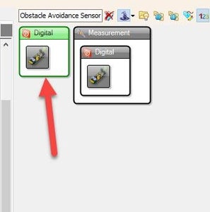

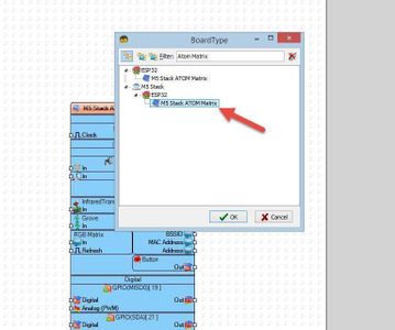

Step 3: Start Visuino, and Select the Atom Matrix Board Type

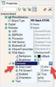

Start Visuino as shown in the first picture Click on the "Tools" button on the Arduino component (Picture 1) in Visuino When the dialog appears, select "Atom Matrix" as shown on Picture 2

- Add "Obstacle Avoidance Sensor" component
- Add "Digital To Color" component

- Select "M5 Stack ATOM Matrix" board in the properties window expand "Modules">"RGB Matrix">"Elements" and click on the 3 dots button

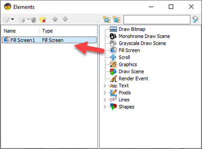

- In the "Elements" window drag "Fill Screen" to the left side and in the properties window select "Color" and click on the Pin Icon and select "Alpha Color SinkPin"
- Close the "Elements" window

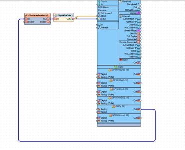

Step 6: In Visuino Connect Components
- Connect "M5 Stack ATOM Matrix" pin [GPIO 25] to "ObstacleAvoidance1" pin [In]
- Connect "ObstacleAvoidance1" pin [Out] to "DigitalToColor1" pin [In]
- Connect "DigitalToColor1" pin [Out] to "M5 Stack ATOM Matrix" > "Fill Screen1" pin [Color]
- Connect "DigitalToColor1" pin [Out] to "M5 Stack ATOM Matrix" > "Fill Screen1" pin [Clock]

In Visuino, at the bottom click on the "Build" Tab, make sure the correct port is selected, then click on the "Compile/Build and Upload" button.
Step 8: Play
If you power the ATOM Matrix module The Display will start to show Green color and you can put an obstacle in front of the Obstacle IR sensorthe the display will show a Red color.
