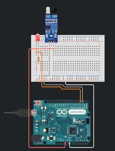

Step 1: Circuit Diagram
Connect the wires to the Arduino as shown.
Note:
No breadboard required.
Picture above is just a reference
Circuit:
Led + to any digital or analog pin
Led - to Arduino GND
IR VCC to Arduino 5V
IR GND to Arduino GND
IR OUT to Arduino any digital or analog pin

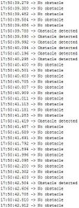

Step 3: Testing
***Remember connect the cable to your PC***
Open your Arduino IDE and click serial monitor (the magnifier-like icon)
What should you see:
When the module sensed obstacle, the serial monitor will print "Obstacle detected" and your led will bright; else the serial monitor will print "No obstacle" and your led will off.
