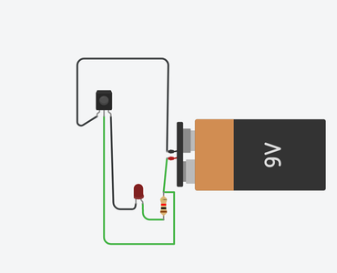

Step 1: SCHEMATICS
This a schematics for the project
Step 2: DEMO OF REMOTE WORKING(trick 1)
FROM LEFT PICTURE WE CAN SAY THAT AFTER PRESSING THE TV REMOTE ,LED IS NOT GLOWING THAT MEANS THE REMOTE IS NOT WORKING.
FROM RIGHT PICTURE WE CAN SAY THAT AFTER PRESSING THE TV REMOTE,LED IS GLOWING
THAT MEANS THE REMOTE IS WORKING
