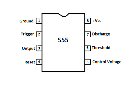

Step 3: Astable Multivibrator in 555:
As we can see the DIP package of 555 IC, in the astable multi-vibrator can provide any desirable frequency range under 555 capabilities without any external trigger pulse. So, it is a free running self-triggered mode rectangular oscillator circuit. This one has two quasi stable states (high and low). Frequency and duty cycle can be adjusted using 2 resistor and capacitors.
Basic Circuit Diagram:
Here in the circuit diagram 100k resistor is R2 and 1K resistor is R1. C is the electrolytic capacitor connected at pin 2 of the IC.
Time for the output should be high: 0.693*(Rt1+Rt2) *Ct
Time for the output of oscillator is low: 0.693* Rt2*Ct

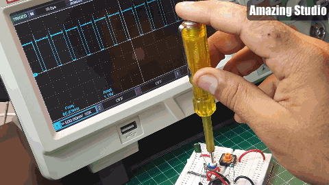

This is the modified circuit layout designed by me and here I made few changes in the basic layouts are: 2 transmitter Led's are used with 220ohms current limiter resistor to the output of 555 timer. This is the square wave oscillator and the time for which the output is high can be determined using the resistor 18k and 10nf capacitor. This circuit can be powered using 9v dc battery through a tactile switch.

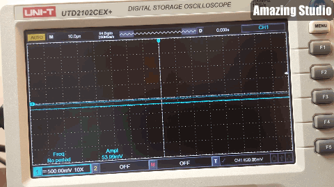

The square wave frequency can be adjusted using the 10k potentiometer. which helps to adjust the frequency between 30khz to 220khz. By turning the potentiometer slowly cause change in output. In this way, we can create a 38khz blank carrier frequency signal.

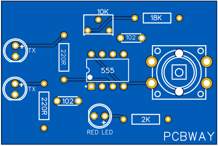

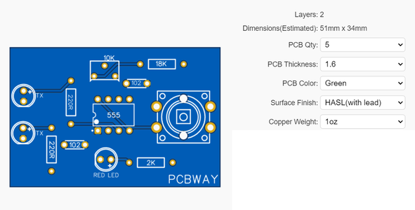

Step 5: PCB Designs:
This is the modified PCB layout and if you wan to use the same designs as mine then get them from here.
If you sign-up to PCBWAYusing this link you will get new user rewards as well as PCB prototype coupons. Battery connector is placed on the bottom layer, a 9volt battery can be connected there.
