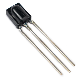

Step 2: TSOP1738 Sensor:
This is the IR receiver decoder and demodulator in a single package. TSOP is the all-in-one dude which can decode the received signal digitally and demodulate it from the carrier wave. This signal now contains only high and low values. By a simple IR receiver, we cannot construct back the original signal that’s why here TSOP is taken in use. This sensor works on a logic voltage and the output is always logic high and pulled to low whenever the IR signal is detected.

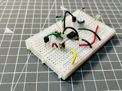

Step 4: Circuit Diagram:
The circuit diagram is quite simple, first we need to set the 555 in astable mode which can produce a fixed clock of 38-40Khz. For tunning the output, we can use a variable resistor in parallel with second discharging resistor. To calculate any fixed value from 555, use this online calculator.
By connecting the control voltage to the transistor. Threshold comparator of the 555 is always gives a high output. And whenever the IR signal is detected the operation is done in a successful manner. The operation can be understood as whenever there is no signal condition the output of 555 is low and trigged as per IR signal this will produce the exact replica of the signal on the output which then converted to logic high values via 3904 transistor and transmitted via the IR LED.
In this way a logic voltage is operated or changed from one to other logic, transistor switches are basic and very crucial unit of this circuit. And these transistor can hold a maximum of 100mA of current any short circuit may damage the transistor directly. In addition to increase the overall signal strength multiple LEDS can be connected together in parallel combination. Which also increase the range and coverage area. All the circuity can be operated with 5v 500mA power supply or battery.

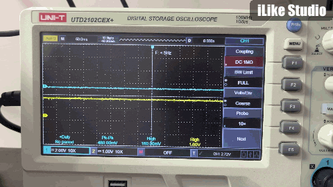

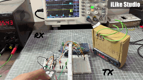

You can observe the signal on DSO, replica of signal is the output through the 555 with the carrier frequency in it. The carrier can be tuned by using an y frequency meter or oscilloscope keeping the IC 555 in astable mode.
Then I made the testing bench in which the receiver and transmitter is far apart and obstacle between them. Direct communication of IR remote to the receiver is not possible and extender play a very great role. See the full video and all the Circuit diagram, Gerber files can be downloaded from here.
