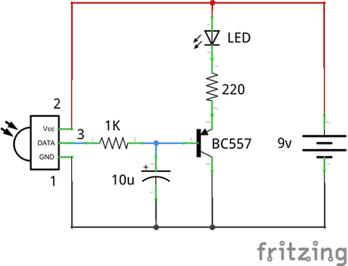

Step 2: Working:
The circuit makes use of an IR receiver which gives a repeated high and low output when it receives infrared light.
TV remotes have an IR LED in front of them which is used to transmit signals so if the LED is working and the receiver is receiving, that means the remote is working.

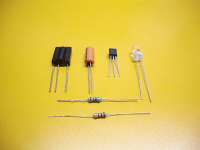

Step 4: Components Required:
• IR receiver (TSOP)
• bc557 transistor
• 10uf capacitor
• 1K resistor
• 220 ohm resistor
• LED
• bc557 transistor
• 10uf capacitor
• 1K resistor
• 220 ohm resistor
• LED

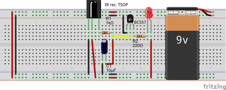

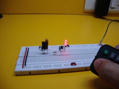

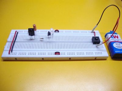

Step 5: Instructions:
Connect everything according to the layout given above. Refer to the image above for pin identification of the components.
Connect a 9V battery to the power rails and switch it on. Now bring an IR remote near it and press any button. The LED would glow indicating that the remote is working.
Step 6: Note:
Use a 6V battery instead of a 9V as TSOP can handle voltages upto 6V only. Giving it a higher voltage can damage it however it still works with it.
Also use a 470 ohm instead of 220 ohm connected to the LED for better results.
