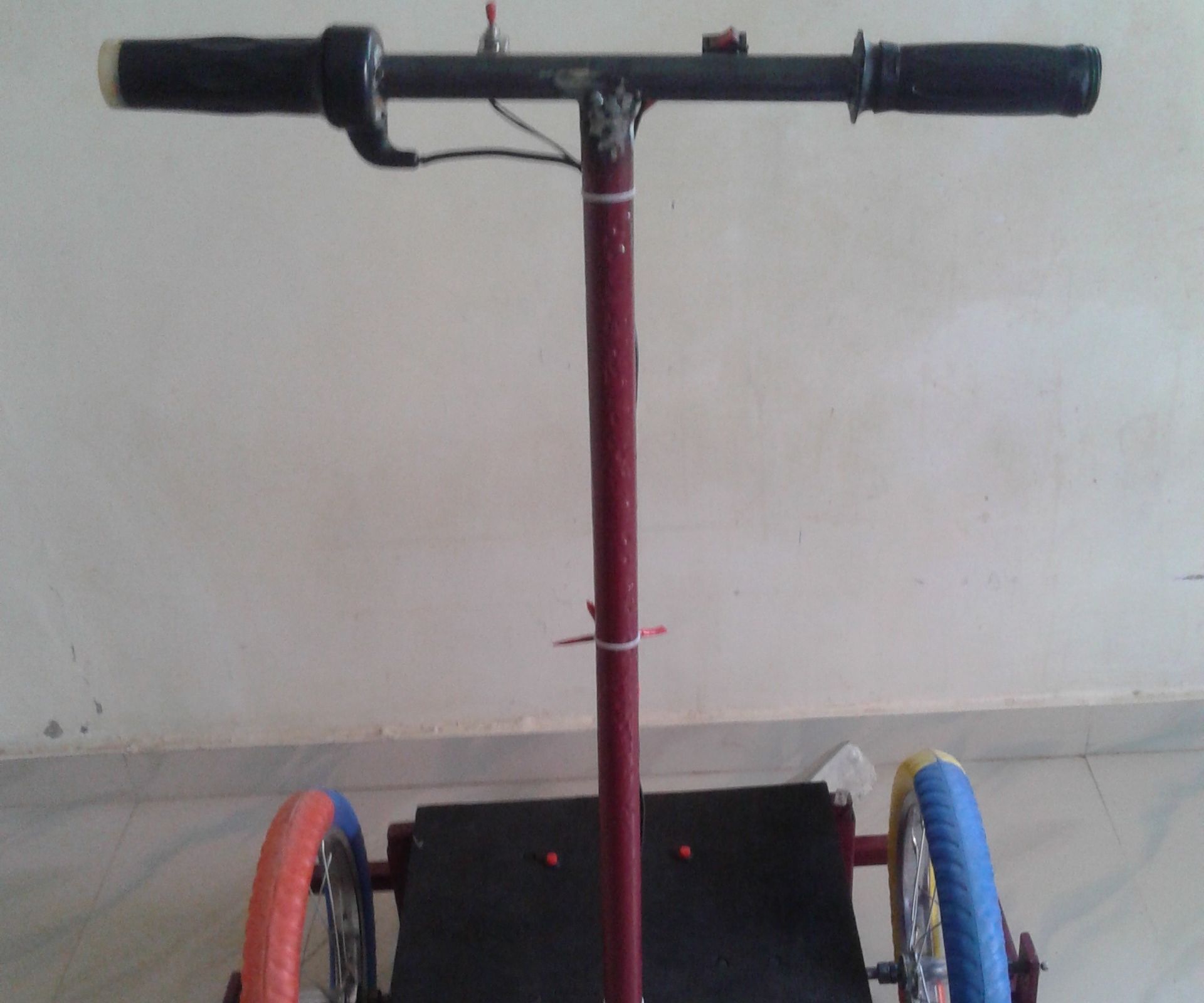

Introduction: Control Toy Car Using Ir Technology
Inspired from my last project Segway, this instructables is all about a toy robot car controlled using T.V ir remote. I would use it to controlling segway with this stuff in the next one . Ok its all done with the help of arduino and ir sensors. The toy car can also vary its speeds using 4 speed levels you can find it in the VIDEO.
