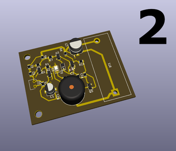

This is what I did too, the PCBs can be seen in Photo1, 2, 2.1.

The PCB will be in a horizontal position and in this position we will place the SMD components according to the project or Photos 2, 2.1. In 10-15 minutes layer of rosin dissolved in thinner it will dry and the SMD components will adhere to the PCB, as seen in the Photo3.1.
