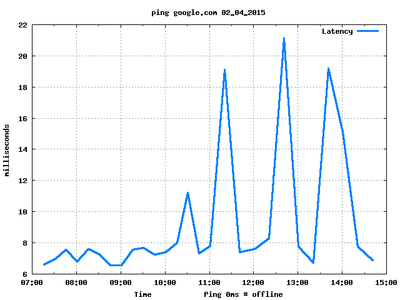

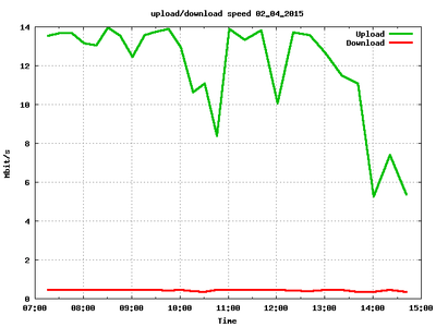

Sometimes happen that my internet connection is very slow or offline. Several times i've issued claim to phone company, but their usual answers was that my modem isn't newest or is broken or ......etc.etc.....
So i wrote this simple script that do following functions:
  • obtain ping value
  • obtain download/upload rate
  • plot a graph and send it by email
With detailed speed report in my hands, i've re-send the claim. After this phone company has recognized the problem.
Now i'm going with 14Mbps of download rate and 7ms of ping, i think it's a good results for DSL connection.

gnuplot -persist <
set datafile separator ";"
set grid
set xdata time
set timefmt '%Y-%m-%d %H:%M'
set xtics format '%H:%M'
set xlabel "Time"
set ylabel "Mbit/s"
set terminal png medium
set output "/home/pi/isr/speedupdown.png"
set title "upload/download speed $now"
plot "$FILE" using 1:(column(2)) t "Upload" with lines lt 1 lw 3 linecolor 2, "$FILEA" using 1:(column(2)) t "Download" with lines lt 1 lw 3 linecolor 1
quit
PLOT
gnuplot -persist <
set grid
set xdata time
set xlabel "Time Ping 0ms = offline"
set ylabel "milliseconds"
set output "/home/pi/isr/ping.png"
set title "ping google.com $now"
plot "$FILEB" using 1:(column(2)) t "Latency" with lines lt 1 lw 3 linecolor 3
quit
PLOT
