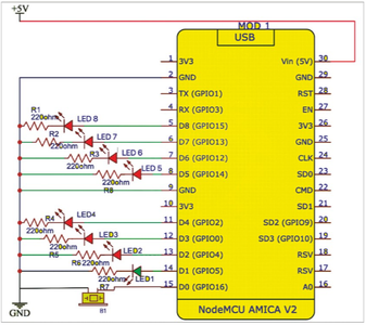

Step 1: Solder Female Header Pins to the Perf Board
Begin by soldering the female header pins onto the perf board. These will allow you to easily mount the ESP8266 board.
Step 2: Solder LEDs, Resistors, and Buzzer
Next, solder the LEDs, resistors, and buzzer onto the perf board according to the provided wiring diagram.
