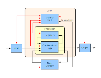

Processors are computer components that handle system instructions, including mouse/keyboard input and (as previously mentioned) running programs and applications. Their task may seem relatively simple at first glance, but in reality, modern-day processors can handle multiple trillions of calculations each second! A CPU is the electronic circuitry inside of a PC that can execute instructions that comprise a computer program. It can perform essential logic, arithmetic, controlling, and input/output operations designated by the program instructions. The vast majority of desktop PCs house a CPU manufactured by either Intel or AMD, and both of these corporations utilize the x86 processor architecture. CPU's are majoritively composed of an element known as silicon, which is a semiconductor. A CPU is made up of several principal components such as the arithmetic logic unit (ALU) that executes arithmetic and logic functions, processor registers that provide operands to the ALU and contain the ALU operation results, and a control unit that coordinates the fetching from memory and the performing of different instructions.

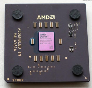

2000: AMD produced and released the Duron processor on June 19, 2000. This was a more cost-effective processor than the earlier AMD Athlon processors, and it was also made available as a competitor to the Intel Celeron processor. The Duron processor was manufactured on the x86 architecture, and the first generation Duron processors went from 600 MHz all the way up to 950 MHz.

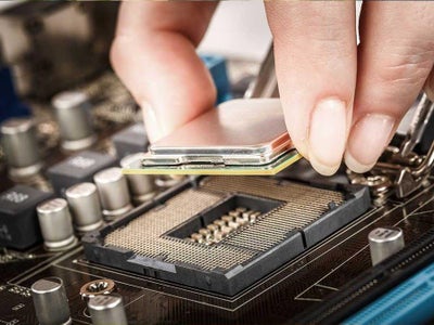

Remove: If you want to remove your processor from the motherboard, you should first unplug the computer from the power outlet and also turn off the PSU's switch on the rear end of the case. You should wear an antistatic wristband or, if not, take necessary precautions to prevent unwanted damage to your computer. Start by opening the case and unplugging the fan's power cable from the motherboard. Then, unlock the fan and heatsink from the motherboard, and then pull each leg upwards to disconnect it. Remove the fan and heatsink from the motherboard. Then, you should remove the latch that holds the processor and lift the retaining piece. You then should simply lift the processor out of the socket while holding it by its edges.
Install: If you want to install a processor on your motherboard, you should completely open your CPU socket by removing whatever is in the way and keeping the retention arm in its open, upright position. You should then line up your CPU with its socket, place the CPU into the socket, and finally close the retention arm to secure the CPU on the motherboard.

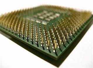

PGA (Pin Grid Array): In PGA, there are pins on the CPU itself, which are inserted into the CPU socket with appropriately located holes. There are many distinct versions of PGA, but one of them known as FC (Flip Chip) PGA was used in 1999.

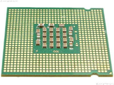

LGA (Land Grid Array): In LGA, the pins are on the socket, and the CPU, which already has appropriately located holes on it, is placed onto the pins. This CPU interface has been used since the year 1996.
BGA (Ball Grid Arry): In BGA, there are balls on the CPU itself, which are then placed into the CPU socket with appropriately located holes. This CPU interface was formed following the creation of PGA.
