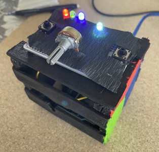

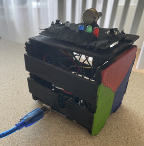

For the box, I found one we had lying around - it contained some shells, pieces of (sea)glass and other beach trinkets, I’m pretty sure I made it as a part of some workshop some years ago.
It looked rough and would definitely leave some splinters if I were to work with it as it was; so my next steps were to sand it down and paint it.
I went for a plain black look, with the sides being more colorful in order to fit the theme of the project.
The dimensions of the box were approx. 10x8x8 cm, which was just big enough to fit the Arduino and breadboard.

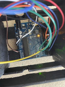

   I’d planned to have the Arduino with all the wires at the bottom and use the lid as a ‘holder’ for the breadboard, with all the interactive parts on a top layer. Then, on top of that, I would add another layer of black paper to make the breadboard less noticeable.
   The lid did not have enough space to comfortably house the breadboard, so I had to cut small bits out in order to position it right.

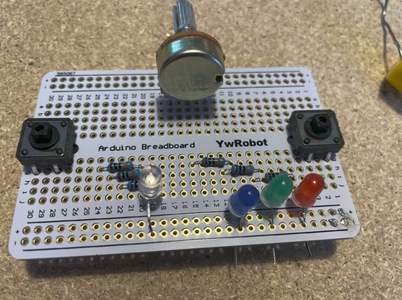

Step 6: The Solderiing
Having been completely new to Arduino work and soldering, I ordered the YwRobot breadboard, which looks exactly like the one I used for prototyping. This made converting the prototyped schematic to a properly soldered one much more intuitive and easy
Soldering in itself was surprisingly fun! I got the hang of it pretty quickly and everything had gone quite well. There was one instance of a poorly soldered wire that ended up quite wiggly and a short-circuiting resistor, but those were both fairly easy to fix.

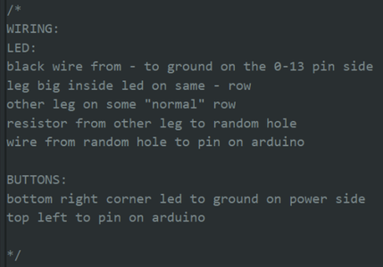

One last thing I leave you with - something that has helped me a lot during the process and I would recommend to anyone else who’s completely new to setting up the parts and wiring of an Arduino project.
Write down comments about what goes where, with which color wire, and into which pin as a comment in your code! Somewhere where it doesn’t get in the way, like at the very bottom. You can always remove it later, and you’ll always have it nearby as a reference when you’re working on your project.
