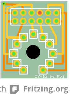

Step 1: Board Design
So using the many threads out there I started designing my pcb using Fritzing.
Fritzing also supply a fabrication service which is well priced and very easy to use.
My design was based on the replaceable bulb style, so using separate plugin boards for the VFD bulbs. I thought this would be better than unsoldering stuff if there is a bulb failure.
The clock would use a real time clock ic and a temperature sensor.
There will be three buttons for menu operation.
I also found a nice little touch ic on HobbyTronics website, this will be used as a button to switch the clock mode between time, date and temperature.
I must admit that board design is great fun, it really brings out the OCD side of me ;-)

Step 2: Boards and Parts
Here is a summary of the parts used, this is a work in progress so this isn't finalised.

Step 3: Board Fabrication
Here are the lovely boards as fabricated by Fritzing :-)
