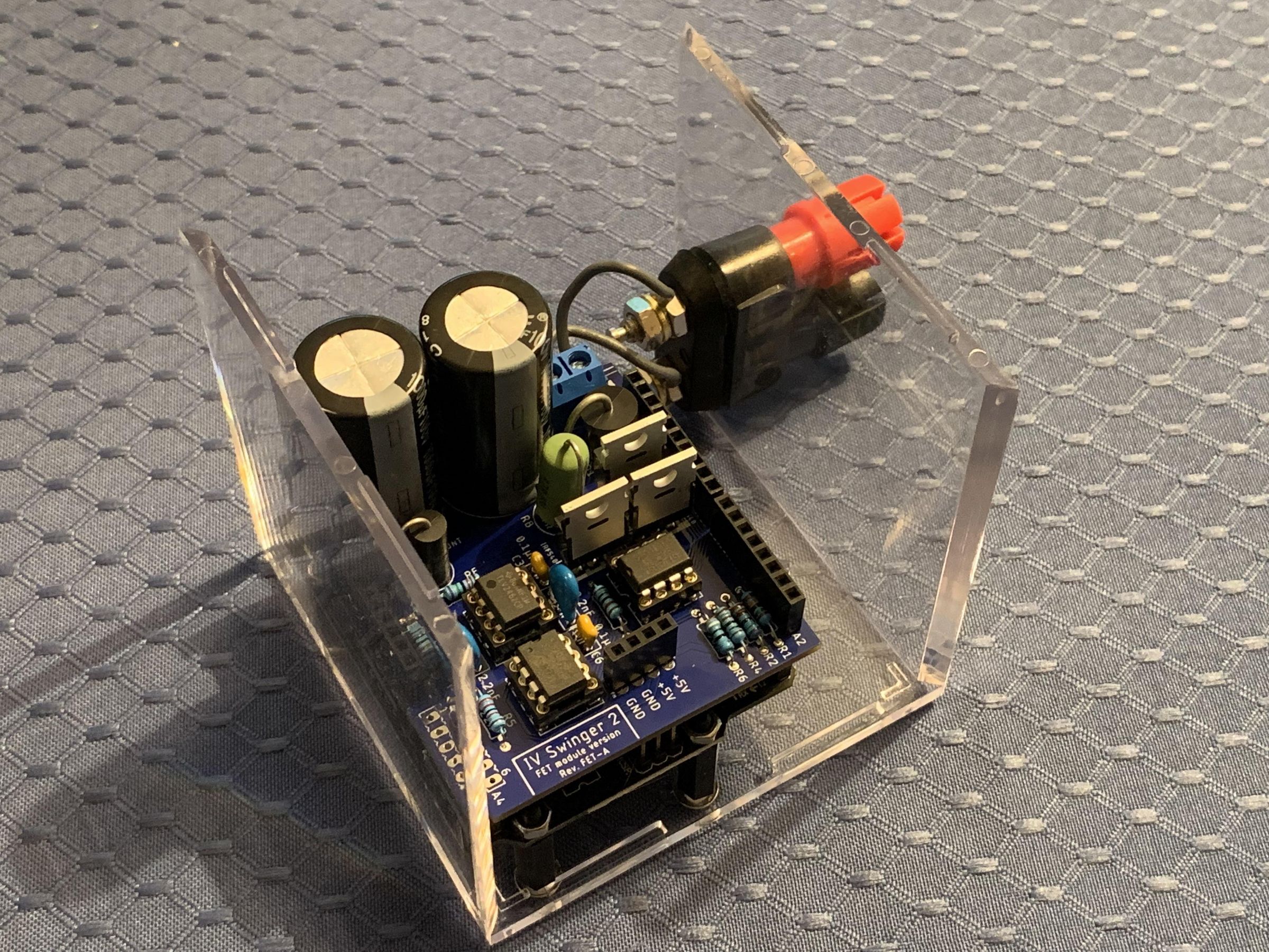

IV Swinger 2 is an IV curve tracer for photovoltaic (PV) solar panels (modules). There is also a version that works with PV cells.
In 2017, the total cost of materials was about $50 (for the least expensive version) but may be more to build a single IV Swinger 2 since that assumes some items are purchased in larger quantities. It also does not include shipping, tax, tools or the Windows/Mac laptop that is required to use it.

The original IV Swinger 2 designs (for PV modules and PV cells) use an Adafruit "Perma-Proto" board and hand-cut, hand-stripped, hand-soldered hookup wires for all of the connections between the resistors, capacitors, ICs, and power/ground rails. Hookup wire is also used for the connections between the Perma-Proto and the Arduino.
Now there are printed circuit boards (PCBs) available that provide all of these connections, making the construction much simpler, faster, and more mistake-proof. Furthermore, there are versions of the PCBs that support on-board solid-state relays (SSRs) or field-effect transistors (FETs) instead of the off-board electromagnetic relays (EMRs).
It is still possible to build an IV Swinger 2 using a Perma-Proto; the documentation still exists and the software doesn’t care. However, it is recommended that moving forward, all IV Swinger 2 constructions use the PCB-based designs.

Step 34: Prepare for Case and Final Assembly
The acrylic baseball display case used for the IV Swinger 2 enclosure needs to have several holes drilled through it for attachments, and the “fins” on the bottom need to be trimmed off in order for everything to fit.
Case side definitions:
- Front: side with the USB connector
- Back: side opposite from front
- Left: side with binding posts and Perma-Proto
- Right: side with relay module
- Bottom: side with Arduino
- Top: side closest to capacitors
The case comes in two U-shaped halves:
- Base: Left / Bottom (with fins) / Right
- Lid: Front / Top / Back
All the attachments are made to the base half. The lid half has nothing attached to it but does need a 3/8” hole in the front for the USB cable.
Care must be taken when drilling acrylic or else it will crack:
- Use a drill press if you have one
- Use vise (with rubber guards) to hold case
- Position so that the hole being drilled is close to the vise jaw
- Start with 1/16” pilot for all holes
- Drill slowly with light pressure
- Spray water on hole as it is being drilled to cool
- Use a Forstner bit to drill the 3/8” hole for the USB cable. Otherwise, you’ll have to start with 1/16” pilot and drill incrementally larger holes until you get to 3/8”
Step 35: Cut Off Fins
Cut fins:
There are three fins on the bottom of the case (to cradle the baseball). Their tips need to be cut off so the Arduino clears them when it is on its standoffs. (Using longer standoffs is another possibility.)
A coping saw or hacksaw can be used for this, among other possibilities. Just be careful not to crack or scratch the case.
Cut off as much as possible, but at least enough so standoffs are longer than the remaining height. _________
