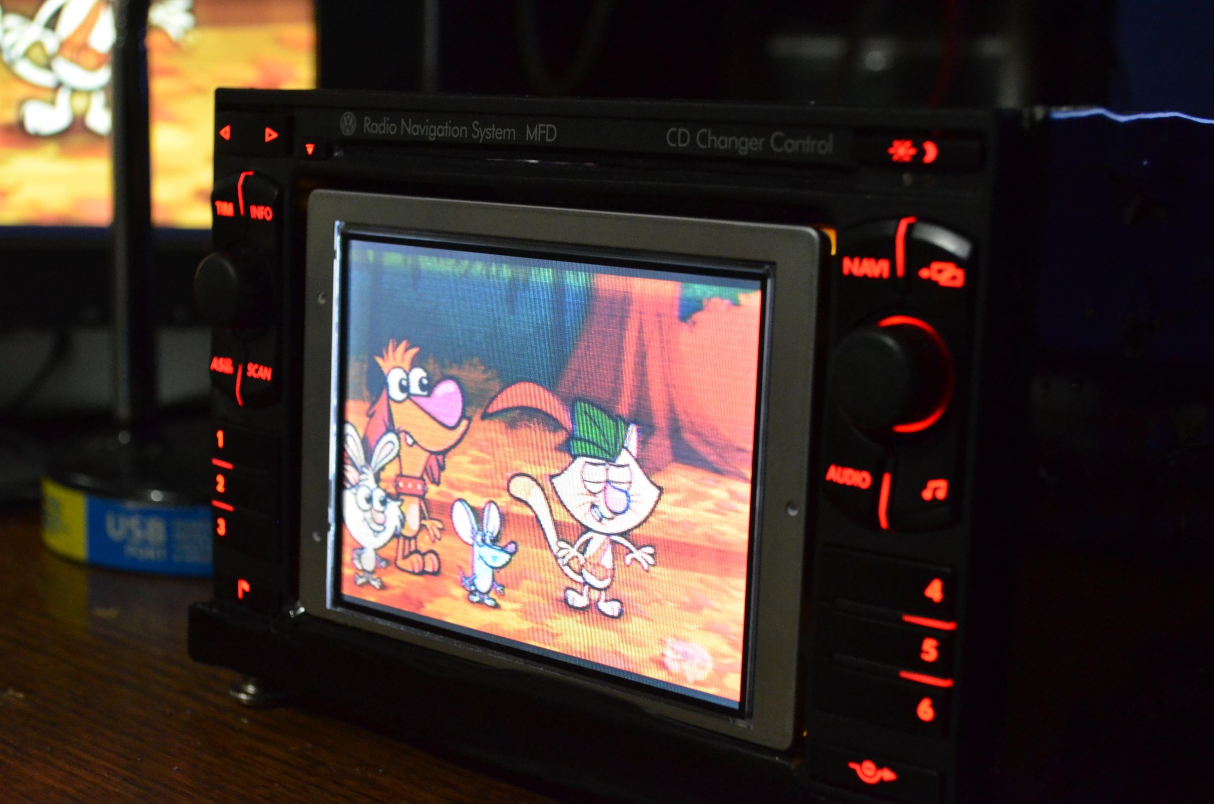

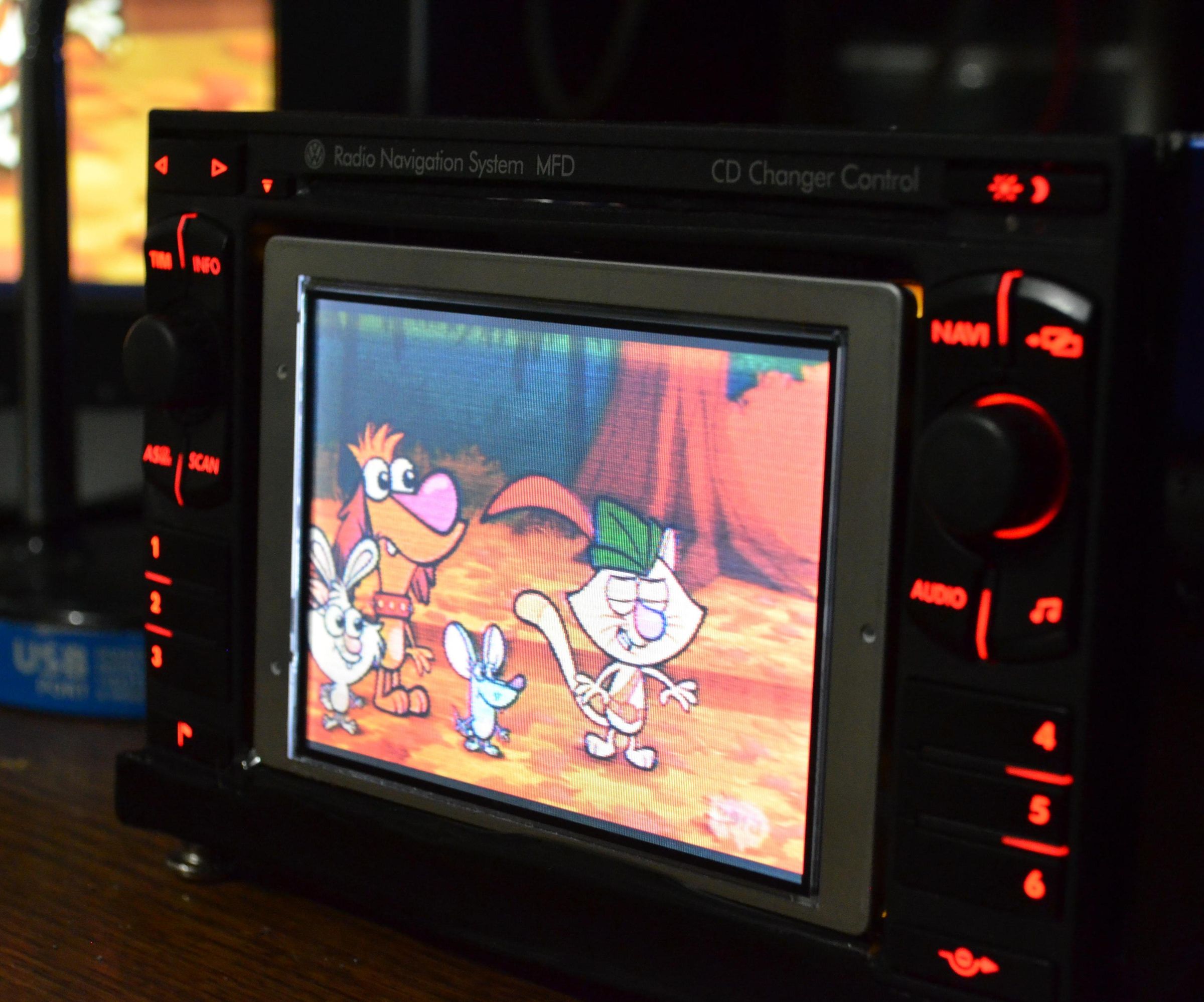

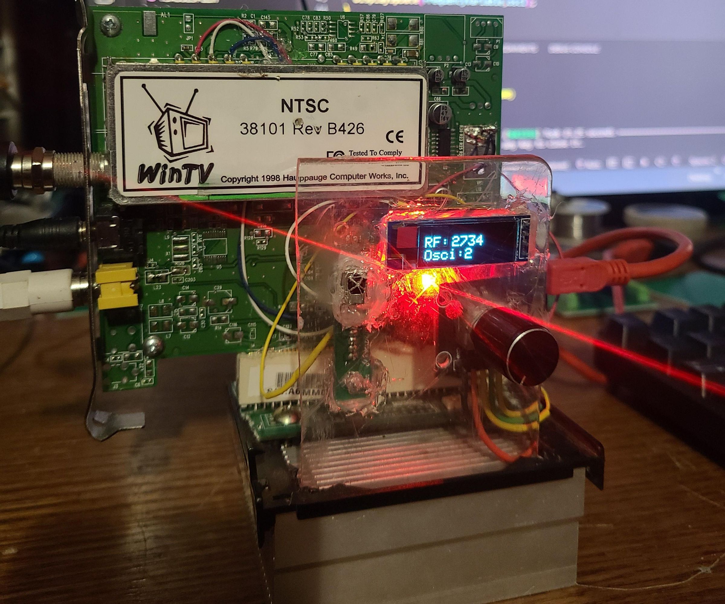

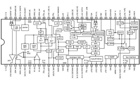

I cut this board from an old CRT TV, It has IX3253C3 IC, Which provides PIF, SIF, Video, Chroma, and Deflection circuit for NTSC color TV. and APL018TT PLL IC. for analog TV

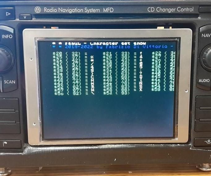

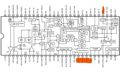

The IX3253CE IC gets red, green, blue, horizontal, and vertical output. to drive the CRT display. I did try to use these signals to drive the sharp LQ5AW136 TFT display, this display uses, Dual mode type [NTSC and PAL] standards, in the form of R, G, B H sync, and V sync. I can't get the vertical pulse circuit to work. but I did find the CVBS signal output from this IC, I got NJM2581 DUAL SUPPLY WIDE BAND 3ch VIDEO AMPLIFIER, to amplify the CVBS signal. and I did use it for FM radio.
IX3253CE equivalent TA1268N
ALP018TT equivalent SN767672A is a single-chip synthesized tuner IC

and Arduino board
Step 1: Connections
9V power for IX3253CE
5V for the tuner IC
30V for the tuner
video output from pin 41
audio output from pin 2
I2C for IX3253CE and the APL018TT tuner IC.

Step 2: Data Sheet
Step 3: The Output
The video and audio are very good

I did code the IX3253CE and APL018TT using Platform IO VScode IDE
