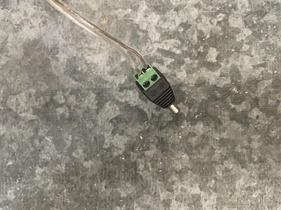

Step 10: Wire Pump and Float Switch
The water pump and float switch are connected to the power via a plug that connects to the jack hanging from the back of the cover (the jack originally came from the pump). The pump and switch are wired into a plug (the panel jack used for the power came with 5.5 x 2.1mm plugs). Since the jack from the cover provides power when the pump switch is on, the float switch is wired so that it interrupts power to the pump when the water level is low.
  • Connect one wire of the float switch to the positive (red) wire from the pump.
  • Connect the other wire of the float switch to the positive terminal of the jack.
  • Connect the negative (black) wire from the pump to the negative terminal of the jack.
Wrap everything up tightly with electrical tape. I added a coat of liquid electrical tape over everything to waterproof it.
